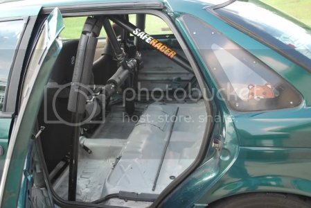

There is no crossbar on the main hoop. Also, I don't care for how it ties in to floor, and not the strut towers.
Edit, I also can't see the base plate for the hoop. You want to make sure that it is a nice, thick peice of metal for the base plate, otherwise it can go straight through the body, as recently seen with a Mustang at Hallet that rolled over. It's bolt in cage went straight through the floor.

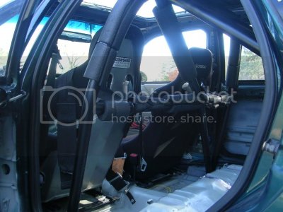

Heres a pic I took of SinisterSHO's car back at carlisle '10. I like how far your head is away from the main hoop.
100 0736

Was that a custom job that Bob had someone do?
I cant dig up any pics of Mikes car. I remember him having some sort of strut tower brace built into the cage.
SHOspazz92
Banned
Jul 31, 2002
6,952
3,672
Triad Area, North Carolina.
Mine also had a strut tower bar made from the roll bar tubing. Mikes had his strut bar (made from the roll bar tubing) tied in to the H-Brace.
IIRC, Bob said it was a custom built unit. It's certainly not a SHOsource unit.
-Sam

Can someone (Kurt?) explain this? Looks like a lot of trouble and compromising went into keeping the rear seats, but why bother, since they're now useless for sitting in anyway. Just aesthetics?
Also, to answer the actual thread, I personally don't think a roll cage and rear passengers should ever mix. Even street driving with a roll cage is a compromise, you have to do a ton of padding and careful design to make the car as safe as stock.
