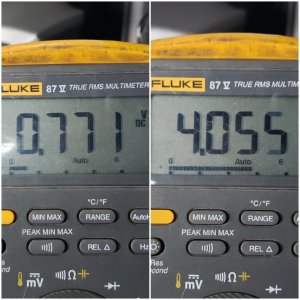

I have looked at the controller manual and you can ramp up for traction control and to reduce that slamming effect on the diff and axles.

Probably just a silly piece of input (this thread is making me realize just how dumb/simple I really am, LOL), but JMS makes a connector for our pedal to output that 0-5vdc signal.
https://www.jmschip.com/throttle-position-sensor-wiring-harness-p-gmp2-f-dcx-apps/
It's what I'm using for my BAP, but is a quick plug and play and might be a better 0-5v source vs throttle body or the MAP sensor, for a number of reasons...
But there may be something a bit more accurate you may be looking at as a 0-5v source...just throwing it out there...

You definitely don't want to use the TB for a command signal, at least not on a torque/load based ecu.
