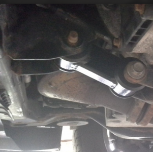

Did you run it with just the rear before having the plates welded on for the front mount? I have a 2017 so I’m curious how much is improved with just the rear mount, or if the front it “necessary”
Yes I ran for months with just the rear, bad shifts, wheel hop gone. But now that I've added even more power, it was time to add front mount. Probably the best investment on my car so far out of the thousands I've spent, have been the AD mounts.
I went almost a year with just rear, had a speed shop weld brackets on frame just a month ago to get front mount on. I gave them front mount with AD mount already installed and they worked everything out on their own. More NVH, still tolerable, with just rear mount my wheel hop disappeared, but when I get around to finishing turbo upgrade, figured why not have a little more strengthening, couldn't hurt. Our years I believe upper mount was improved or something like that and that's why the front torsion/trans mount was deleted. This isn't my picture, it's from a member on here and I can't remember but anyway the shop duplicated this for little less than $200.
