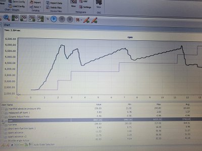

Yeah for sure, let me know I’m curious. Either way, if he saw something in the log regarding my TC then I guess there’s gotta be some sort of issue there.
He just emailed me and said my logs look good. His exact words were, “maybe another point of octane to be perfect, but other than that nothing else to change.”
I did put the extra pint of trans fluid in this morning, and it’s shifting smoother across the board, but you said you already did that to yours. Even my 5th to 4th is smoother than yesterday. Im just gonna keep and eye and give it more time to adapt. I’m thinking it’s that, and the advance trac not liking the extra torque at first maybe.

Update - so I have the GH tune in, extra quart tranny fluid and correctly gapped plugs now. Been running it for a couple weeks, and probably have roughly 200-300 miles or so. Before I uploaded the tune, I did a kam reset and it’s definitely improved and adapted since then. BUT (and I’m starting to think it’s a mechanical part on my car and not the tune, since the tune is fine for everyone else…), it still does this funky hesitation/shuddering shift, which is more prominent with WOT and accelerating around turns. 1-2 is butter, 2-3 is where its the roughest and 3-4 and so on are also kinda choppy but to a lesser degree. As I stated before, me transmission is new from the dealer as of 20k miles ago. I sent in a log to Matt and he said the only thing he saw was that my torque converter was having trouble locking. I read up on torque converters and the symptoms and I guess it could be that. Anyways, my update is that GH is much better than LMS, but I still can’t drive the car WOT or “freely”, I always have to be cautious/mindful how much I’m accelerating and the timing for it to not shift so hard. It’s also not consistent - one time I can go 2-3 with 90% acceleration and it’s relatively fine, then next it shuddering into 3rd gear and it freaks me out. It’s drivable no doubt, but I wanna be able to get it to shift like butter whether I’m going around a tight bend and acceleration or doing a 2nd gear pull starting at 3000 rpm’s and pinning it. Any other info is greatly appreciated thanks boys.

Yeah. So, I just received a “softer shifting” tune. It did help overall, BUT still, from 2-3 it just feels like it’s almost going into fear too quick, which makes my slightly jolt in my seat. Bottom line is it doesn’t sync up and feel like butter like 1-2 does, when it should… 3-4, 4-5 and 5-6 aren’t nearly as noticeable as 2-3. We’ll see what happens, maybe it’ll adapt more to this modification but I doubt it…

UPDATE: I called the Ford dealer, they said they 110% replace the torque converter whenever they replace a transmission (which was replaced 1.5 years ago). Matt from GH was talking about strategy codes and the valvebody with the new tranny as well, so I asked about that and the Ford dealer said they have to do that or else the new transmission just won’t work right. Now, the torque converter could have gone bad over the last 1.5 years, although I doubt it? Kinda just bummed. No idea what this could be. Matt sent me a softer shifting tune which helped minimally, but the problem still persists. I do have a warranty so I can bring it to Ford for free but in that case, I’d have to revert my car back to stock and then the problem may not be there anymore, in which they’d probably just tell me that everything is fine. Dealt with this issue with LMS for almost 2 years, decided to buy GH and it’s still here. I still doubt it’s the GH tune since all of you have like no issues, but damn, tranny mounts could be contributing but I doubt that’s the culprit of all this. Annoyed.
