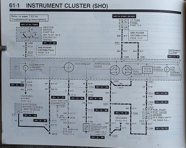

The float for the gas gauge is in the tank as an integral part of the fuel pump assembly, not the pump itself. I doubt if there's anything wrong with it. Best to check out the gauge circuit. There's a removable slosh module in the back of the instrument cluster that may have gone bad. I'll see if I can post the circuit diagram later on.

Thank you all so much for responding to my thread. Ended up paying for the speedometer not working via state trooper. Seems like all the cables need some lubrication, but as far as the gas gauge goes, when the electrical turns on the gauge slowly goes up as it would normally, and then it goes to the very top of the gauge and doesn’t budge. I feel like if it were an electrical connection it would just sit on E, not go all the way up past full. So assuming it’s the float and/or mechanism in the fuel pump, that means I need a whole new assembly?
That's pretty much the problem I had with an '89. Turned out to be the slosh module plugged into the back of the instrument cluster. The '92 has one as well. I'm pretty certain they are all the same 90-95, but the '89 is definitely different. Although the sender might be the culprit, it's less likely IMHO.

My problem was the opposite of yours. Turn ignition on, gauge goes to 1/4-1/2 full but then slowly returns to zero.
If you ever take a look at the sender in the tank, you can check the resistance out by raising and lowering it: 22.5 ohms empty, 145 ohms full.

A quick ebay search of Ford slosh/gage module shows it looks like a small circuit board. Is this easily replaceable? I had not heard of this part before either. Ad says:
Product controls fuel gauge while driving, allowing the fuel level to remain constant while fuel "sloshes" around.
looks like there is someone selling NOS ones that are supposed to be compatible for 90 to 95 Taurus, search for:
NOS 1990-1995 Mustang Anti-Slosh Module / Instrument Cluster Voltage Regulator

The slosh module is plugged into the back of the instrument cluster, which has to be removed to get at it. Then it's a simple matter of pulling it out. The eBay listing says it is compatible with your '92.

I’ll troubleshoot first thing tomorrow and see what the issue really is, I’ll keep you guys updated. Looks like in order to troubleshoot, you have to (and I’m quoting from the info I found) “If you disconnect the harness at the sending unit and the gauge reads full then your sending unit is the problem, if the gauge doesn't move then it’s your anti slosh module.” In case anyone was wondering.
