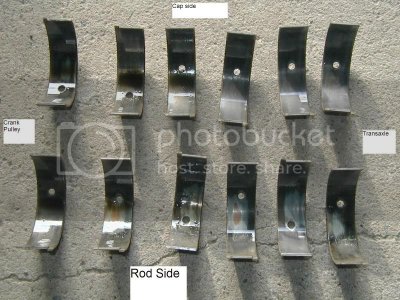

I got as far as bearing #3 tonight, similar to your's but a little more copper showing. This is on my dad's 89 with 113K. Everything went smoothly except for that broken exhaust stud :(
O thats nothing, i stripped the nut on the oil pan where the front engine mount is, i had to take that whole bracket off to get tools in there to get it off, i would have love to break an exhaust stud lol.

I did it to Bandit back in the fall and it was right around 100 bucks for everything and thats even including the food i bought during the break hehe. It was my first time and i started at around 8 that morning and got done around 8 that night cuz i took my time and made sure everything was done right. When i started bandit up he had a new lease on life. I plan on doing this project again pretty soon on Bandito. I just have the problem with not having enough time on my hands. Before i did the bearing job on bandit i could hear a light tapping noise at around 2500 to 3,000 rpm driving through neighborhoods with the windows down. All of mine looked ok except for the last one furthest from the oil pump. My guess is that it got starved of oil at some point. It had 153k on it when i did that. The car ive got now has around 165k on it with meticulous maintanance history from day one and i dont hear any noise or see anything weird but i still want to do it for peace of mind.

I just had the rod bearings replaced @ 227K and all 6 rod-side bearings were showing copper. Here is a site to purchase the bearings. I bought the kit and paid a mechanic about $210 to install the bearings. RCM delivered the kit quickly and they were so well packaged you'd have thought they were sending Fabrege eggs.
