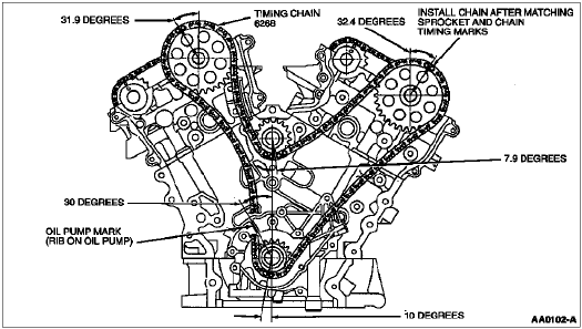

yep, the on front intake cam the sproket has walked about 1/16th of an inch. Distinctive scrathces on the cam. I am going to pull the cams and take them to a machine shop to either be pinned or welded. My question is I can pull everything without pulling the motor but with the sproket having walked
how do I re-time the sproket on the cam.
I see the markings on the sproket does that line up with the ****** on the end of the cam. I understand that these maybe easier to re-install with the motor dropped. Is there a link with some infom all i can find is shops that will do it. I don't have the money to pay some-one. I have a ford authorized mechanic, and a machinist that can pin or weld them. But how do I get the sproket in the corect spot to be pined sinc eit has already walked?

Not really that hard. By the way, you might notice on the top of the V8SHO site a Google search function. Typed in "Cam sprocket timing" and came up with the following link. Even has pictures! Cam Sprocket Timing
By the way, I have removed the heads in the car, but I sure the **** would not want to try to put them back on in the car. Took me less time to get the whole engine and tranny out then it did to remove just one of the heads in the car. You are probably looking at tossing a few valves out, replace them along with the head gasket and lower intake gasket and slap it back together. Shouldn't run you more then $1,500 in parts including the cam. I would strongly recommend getting them all welded shortly thereafter since you might note several lucky individuals had multiple failures on one engine just a few months apart. Also another handy picture is:

For when you get ready to put it all back together.

well i redone mine in feb of this year spun cam, and mine had a told of 8 bent valves in the front head and 4 bent on the back head and the only cam to fail was the front intake, when i re timed mine i was low on money and took some art and craft supplies for wal mart and protractor and made me a set of degree dials and used some fishing line and weights to get a striaght 90 deg up and down with the ground, i got all of them in line then found my marks on the chain there are sometimes hard to see. and be hold all the marks was in line perfect and then i finished the reinstall. runs great.

Just had my cams welded. Mine had the same markings and after removing the cam I could slide the CAM sprocket back and forth down the cam. Just cause the sprocket walked a little on the cam doesn't mean there is anything wrong with the rest of the motor.
Yes the timing dimple on the sprocket lines up with the timing mark/dimple on the end of the cam.
You can blow compressed air into each cylinder (threw spark plug hole) to determine if any valves are bent. If they are bent then you will have severe blow by through the affected intake/exhaust valve.
