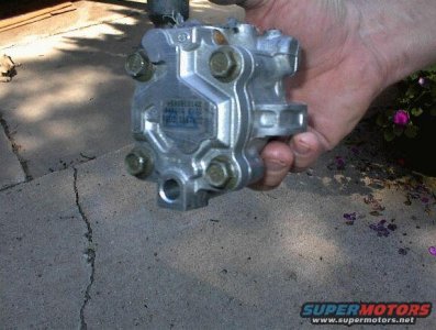

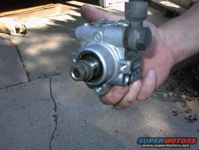

Thanks for the pictures! Do you know if the gen3 PS pump will fit on the gen1/2 mounting bracket and line up properly with the belt system? I don't think I've ever seen one so I can't begin to guess..
My guess is that it will not, but I do not have one in hand to compare. I may try to lay hands on one at some point.

Was just eyeballing my Gen 1 pump and that might not be too hard to do. Probably need a custom pulley. Got any dimensions off that thing? Who was the mfr (also ZF, or...?)
Hmmm, both have 3 bolt mounting. Paul, is the shaft on that pump splined for the pulley?
I wouldn't be surprised if that bolts right up (although the offset may not be correct). Is there a difference between gen3 pumps or are all duratech PS pumps the same?

Yes the splines are for the pulley.
The manufacturer is ZUA.
What kind of dimensions do you want?
BTW the Gen 3 hub with bearing and ball joint weighs 13 lbs. And as far as I know there are no Gen 4 aluminum control arms.
Center-to-center on the front mounting holes (just across the two 180-degree opposed top holes is good enough), thickness of the pump from the face of the front mounting hole bosses to the face of the rear hole boss, front mounting hole face to the end of the shaft.

C-C ~2.1"
180* opposed is ~2.8" across
Top two bosses are 1.4" and the bottom, center one is 2.65" which is to the back plane of the pump.
The GEn 3 uses a bracket that the pump is mounted to then the braket is mounted to the heads FWIW.

C-C ~2.1"
The Gen 1 pump is 80mm (3.15in) center-to-center across the top two front mounting holes, and 57.3mm (2.26in) thick from the front face (at the mounting holes) to the rear face (at the mounting hole.)
When you say 'center one is 2.65in' do you mean that's the thickness of the pump?
If so, the Gen 3 pump is no wider, a little squarer in shape, and about .30in thicker than the Gen 1 pump. Depending on the inlet/outlet fitting positions and the shaft/pulley work involved it might fit in a Gen 1 bracket with some minor machine work to the bracket (mill the back of the bracket off and weld on a steel plate spaced out an extra 0.3in, and maybe cut some slots in the lower corners of the bracket to clear the squarer Gen 3 pump body.)

The output port on the Gen III pump is backwards and comes out on the wrong side. The outout port on the Gen I/II pump is on the opposite side.
I don't think there's enough room to route the pressure line behind or below the pump.
If so, the Gen 3 pump is no wider, a little squarer in shape, and about .30in thicker than the Gen 1 pump. Depending on the inlet/outlet fitting positions and the shaft/pulley work involved it might fit in a Gen 1 bracket with some minor machine work to the bracket (mill the back of the bracket off and weld on a steel plate spaced out an extra 0.3in, and maybe cut some slots in the lower corners of the bracket to clear the squarer Gen 3 pump body.)[/QUOTE
Total thickness of the pump from back to the end of the threaded pully mount is ~4.35"
From the pump back to the nose on the pump body which holds the front bearing is ~3.4"
Width is ~3.5"
Width at the top is ~4.0" including the output banjo fitting, ~3.5" not including the banjo fitting.
Height is ~3.65"
Yeah, absent the possibility of mounting it upside down or some such, and some concrete indication that the Gen 1 pump isn't sufficient, it's probably not worth the effort to pursue. Though one wonders whether the housing could be drilled through to the opposite side, tapped for a fitting, and the existing port plugged...

No way are you drilling and remounting the in/out ports. The big banjo fitting output has some sort of metering setup in it. The fitting though can be modified as I tapped mine for 3/8" NPT.
It's obvious you can use the Gen 1/2 pump (which is speced the same as the GEN 3 Duratec) due to the fact of successful transplants. But is the pump up to the flow needs of an active variable ZF ps rack?
