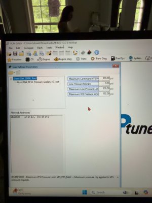

So basically I reached a point where the existing commercial definition could no longer answer the question. Instead of guessing mechanically or globally increasing pressure, I obtained the OS documentation, identified the missing control path, and worked directly with an HP Tuners engineer to expose individual VFS pressure scheduling. Now the next test can separate insufficient commanded clamping force from an actual hydraulic or mechanical fault.

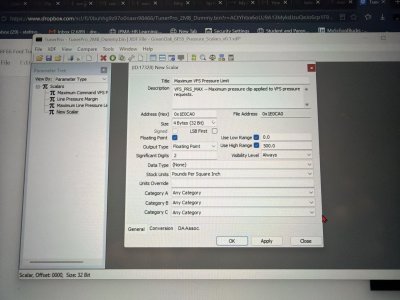

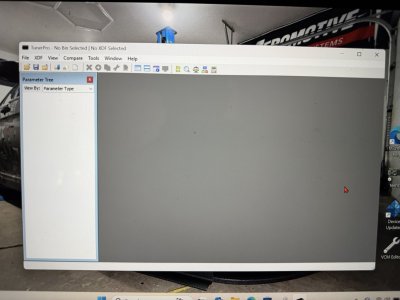

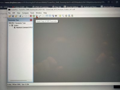

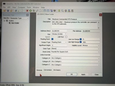

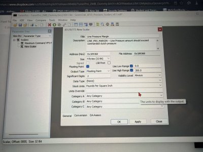

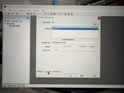

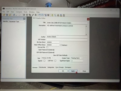

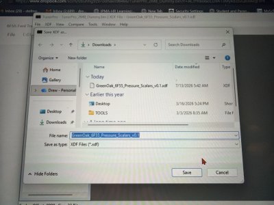

Holy f shit. So I had my digital assistant help me setup TunerPro and make an XDF file to add scalars myself to HPTuners after buying a user defined license. It worked flawlessly! Check it out! It even sent me a dummy bin file to satisfy a TunerPro bug that was originally stopping me from completing a scalar. I downloaded it and uploaded it to TunerPro and it let me start making them. So f cool. IMG 1195IMG 040E4B43 3F78 45E6 846F 9A99B1984695IMG 10611CD4 C5EF 4D42 B319 E564C21D69ACIMG 1194IMG 6B34DB5F 2B92 4BF4 B2E8 FDAE9A661B39IMG 952625DE 036A 4175 AA44 6FBB573AB36AIMG DF9D088F 32FF 4327 BAB6 7B38031E19B0IMG D0C30BA7 4B1A 4F1A AC9C CACB52A49897IMG E28E2FCA E548 4D0C 9A92 CD0C920FC872
Next I’ll learn how to setup a 2D table
