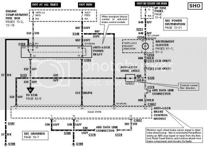

near as I can tell, the accy feed fuse goes to: anti/lock power relay, anti/lock brake control module, and on the otherside, the igintion swich.

correct. The relay may be the culprit. The relay is mounted on the radiator support, right behind the driver's headlight assembly. It's a wee little black box that has wires coming out the bottom of it. This may be shorted out. An easy way to check is to pull the harness out of the relay. If it still blows out, it's not the relay or anything downwire from it. Here, look at this schematic:
ABS
That should help. Go hunt!

or check the relay. put 12V across the coil and see if it switches. You should here a click. Also check resistance of the coil. Coils vary in resistance but if you get <1 ohm u got a short, if its >100k you got an open.

For diagnostic purposes, just unplug the relay and the ABS module and see if the fuse quits blowing.
