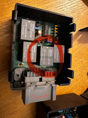

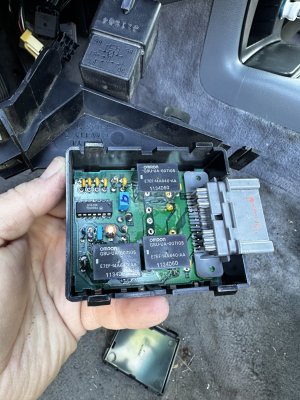

Can’t believe it’s been a year—just wanted to put a bow on this in case anyone else needs to refer to this thread in the future. It was indeed the wiper module under the dash. Pulled it and had a friend I know test the board - specifically it was one of the large relays on the board, located in the middle of the row of 3. I’ve circled it on the board in one of the attatched pictures. It’s labeled “OMRON G80S-UA-007112 F3LF-14A640-AA” (also pictured). You can also see my board—minus the relay—to see where it was originally. We jumped the pins and I was still able to use the wipers kind of, until I (only last week) was able to get a replacement off of a parts car and get wiper operation back to normal.
I spent a ton of time looking up the relay, hoping I could buy a replacement or even just figure out the specs so I could find a compatible one but there’s no documentation about this part at all. I’ve seen on some other ford forums that it’s used on a few different ford models across multiple years, but I’ve not seen any comprehensive list of info on what models or years. If I wasn’t able to find a parts SHO thanks to a friend, I would have gone to the pull-a-part and started checking wiper boards from other fords from the era and hoping one of them had one of these relays.
Huge thanks to everyone for your help, especially @Steve93 for pointing me in the direction of the wiper board!
