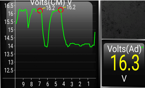

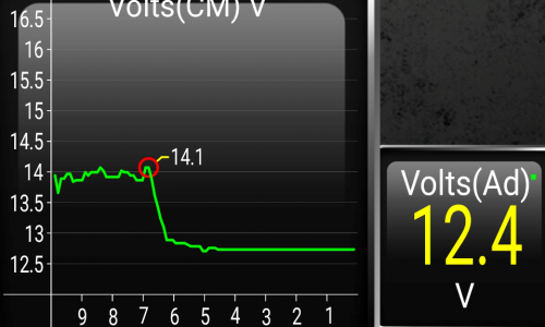

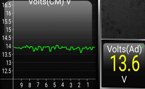

I started getting a sporadic BMS fault (the battery image on the cluster's display).
Using Torque, I started monitoring what was going on and found that there were instances were the voltage would peak up to 16.4V but most of the time it would stay below 14V. Voltage with the engine off shows at 12.4V.
When it peaks above 16V, the AC system shuts down, I guess to protect itself.

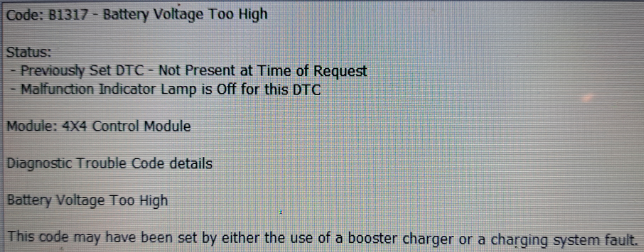

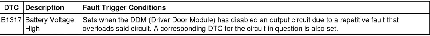

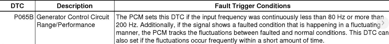

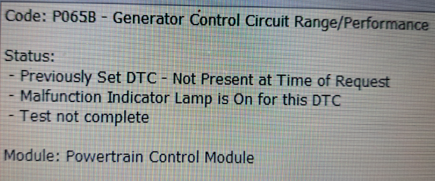

Forscan shows the following codes:
1697638755791
1697638783889
1697638806884
1697638826565

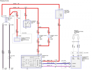

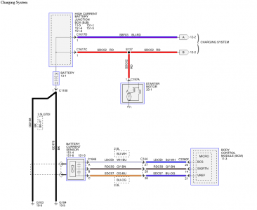

so here is from alldata:
what is the state of charge or SOC? Note:Verify the battery state of charge (SOC) is greater than 70% before diagnosing any auto stop start concerns. Refer to the Workshop Manual Section 414-00, Charging System, for additional information.
In short for me - a ****** of a repair - faulty BCM - or maybe a door / seat module being faulty? read those attached docs - generator is still in the picture unfortunately.
Possible Sources
- Wiring, terminals or connectors
- Battery
- Generator
- PCM
- RFA (Remote Function Actuator) module

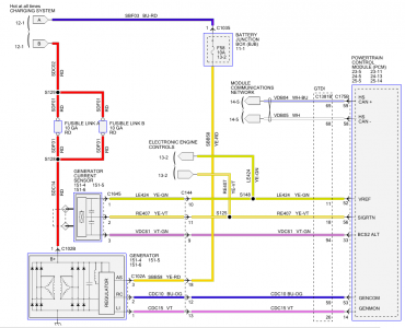

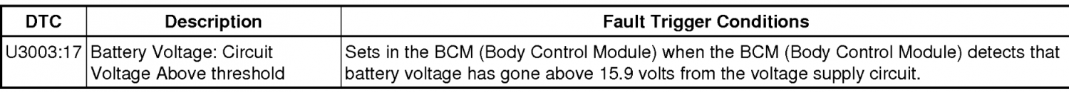

PINPOINT TEST G : DTC U3003:16
G1 RECHECK THE BCM (Body Control Module) DTCs
- Ignition ON.
- Enter the following diagnostic mode on the scan tool:BCM (Body Control Module) Self-Test.
- Using a scan tool, clear the DTCs. Repeat the BCM (Body Control Module) self-test.
Is DTC U3003:16 still present?

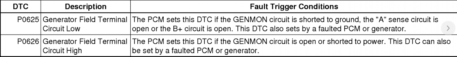

The relevant codes are P065B and P0625. The others are incidental to these codes.

Additionally, you have a 2010 model. The BMS didn't start until the 2013 MY.
Three possibilities 1) alternator 2) wiring 3) PCM
  • Principles of Operation.pdf

From the Principles of Operation:
The PCM is able to adjust the charging voltage according to the battery temperature by using a signal from the Intake Air Temperature (IAT) sensor. The PCM also uses other inputs to control charging system voltage such as the Vehicle Speed Sensor (VSS) and Engine Coolant Temperature (ECT). The voltage set point is calculated by the PCM and communicated to the voltage regulator by the GENCOM circuit based on the needs of the vehicle and the conditions.
My vehicle was low on engine coolant which I now topped up with no change. Maybe that affected the ECT reading misleading the PCM?
There is also something else I don't fully understand about the Check Charging System (let's not call it BSM anymore) going off after the engine goes above 2000 rpm.
A few days ago I disconnected the battery for more than 2 hours while I was cleaning some connections and the shift tables and other things reset. Something that changed is that before that I would get the CCS (Check Charging System) alarm after a short period of driving and it would go away, and then come back, and then go away... After that day, it comes on within 10 seconds of me turning the engine on, even if its still idling, and it won't go away.
I'll go over the connections again this weekend and will re-read the info sent. Some of it I don't really understand but will try my best. Will also go through forscan again to see if I can find a way to properly reset this system.

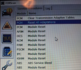

Last night I ran some tests using Forscan, all came good, right now only code P0625 is coming up.
1698170323854
Not sure how to reset the Charging System Alarm, maybe by resetting the PCM - All Adaptations?
