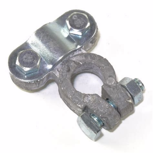

ive tried putting new battery ends on the cables
This may also be a problem. Did you use proper crimped terminals or temporary repair terminals, example below? If it's not a problem now, it will be in the future.
