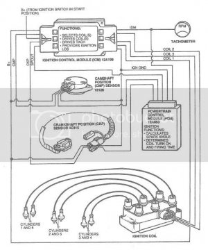

Also, you need to use thermal paste, not dielectric grease. If you are using grease that explains the DIS failures.
-sorry---NO, any paste or no paste will not cause DIS failure. The DIS just MUST be well grounded.
Zach, you need to go to the computer store and buy some heat sink paste and put on the back of the dis - dielectric grease does not do what you need - you are overheating the dis by not having the right heat sink paste for thermal conductivity.
- again, NO. The cross-over tube can be more of a heat source than a heat sink. The DIS does not generate much heat at all & sitting above all the belts & pulleys, it get lots of air circulation. All my SHO's have no paste on the DIS & are actually spaced 2-3mm away from the cross-over tube. BUT the DIS is well grounded. If you look at the schematic for the DIS, the bottom 2 mounting holes are the ground path. I run a separate wire from those mounts to a new ground screw on the strut tower. Some of my intakes are either polished, painted or powercoated so I don't have to worry about a good ground path for the DIS. Even stock, the factory complicated ground path on a 20 yr old car gets compromised.

I still say you need to run heat sink, not electric grease. I HAVE seen a DIS fail because of this. And yes, while a ground is important, a bad one will not fry a DIS or only cause it to work sometimes. It would will either not be grounded good enough (No start), or be have a good ground (Causing it to work).

I don't think the grease was there so much as a heat sink as much as it was there to keep water from between the two aluminum plates. Water between the plate will cause corrosion in short order.
Clean it, stick any kind of grease in there and ground it (the DIS that is; the only reason the intake is grounded is for the DIS AND to get all the static buildup the intake gets from the electricity from a running engine, back to ground).
Static buildup causes a lot of problems in electronic circuits, so it's better to throw up a grounding net to channel it back to ground rather than the charge finding its own way through sensor circuits.

So as long as i have a good ground from the manifold to the firewall or a good grounding surface the DIS should be fine. Right now i have the ground strap on the crossover tube braket. Its pinched between the rear of the manifold and the braket with the 12mm bolt. Im thinking of making a new ground strap and grounding it where the stock position was just to for a extra insurance.

Bill, you have been very lucky. I have seen dis fail for both people using dielectric grease and no grease, although they were well grounded.
Ford tells you that heat sink grease is required because it is required.

Zach...the BOTTOM 2 screws on the DIS are the important ones. If you've only got 2 screws holding it in they NEED to be the bottom ones. Just thought I'd throw that out there. The DIS is NOT grounded unless those bottom 2 screws are tight.

All four screws where in and snug. Something is telling me the dielectric grease is messing with it, Im just going to take everyones advice and do everything.
1.Heat sink grease
2. resecure ground strap
3. Test the alt to see if the voltage regulator is bad.
