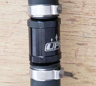

I can’t do any tests at this time but I have the UPR Dual Valve catch can. I almost immediately ordered and swapped out their check valve for a high pressure check valve....bc with the supplied check valve there’s potential for the contents of the can to get sucked back into the engine under high boost. FWIW.
edit: this is what the rep from UPR told me. Even if this isn’t the issue...probably a good idea to do it if someone hasn’t already.0C585ECD 341B 4E84 AA48 04EBB46272EE
edit: this is what the rep from UPR told me. Even if this isn’t the issue...probably a good idea to do it if someone hasn’t already.View attachment 18052
Hmmm, I was never educated on their higher flow check valves, but is possible this could be happening.
EDIT: now that I think about it, I think I have their larger ones. I've seen their older kits with small check valves....unless the one I am adding to this is not their larger one...

I’d have to dig it out of some tots, but that looks like the upgraded one. The one that comes standard has one arrow on one side and UPR on the other.ImageImage

Yeah, looks like I have their larger ones already...
