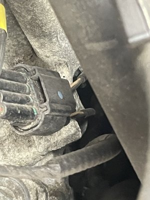

Check the knock sensor wires for chafing. Was more common on the 2010-2012’s but still could be a false reading.
Took a look. Yeah there’s a good chance this could be the cause, I honestly never would’ve noticed this unless you told me to look. Regardless of whether or not this is the problem is so shoddy, I don’t know how ford thought this was ok. That’s wiring right on the hot engine. I’ll either wrap it in some electric tape or use a tie to move it out of the way later this week. IMG 9896

Took a look. Yeah there’s a good chance this could be the cause, I honestly never would’ve noticed this unless you told me to look. Regardless of whether or not this is the problem is so shoddy, I don’t know how ford thought this was ok. That’s wiring right on the hot engine. I’ll either wrap it in some electric tape or use a tie to move it out of the way later this week. View attachment 93788
Good find, idk personally if that’s directly related to the timing or just detonation. That would be a question for a qualified mechanic but still worth a check for sure.
ziptied it out of the way, taped up the wires with electrical tape, dumped some octane booster in it just to be safe, and cleared the code last evening. code came back on today during my lunch. I'm gonna try a crank relearn later today using my SCT, and if that doesnt work im gonna assume its either timing chain or vvt solenoid
