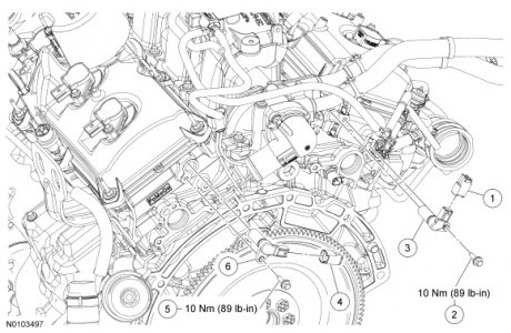

Camshaft Position (CMP) Sensor — 3.5L GTDI​
Material
ItemSpecification
Motorcraft® SAE 5W-30 Synthetic Blend Motor Oil (US); Motorcraft® SAE 5W-30 Super Premium Motor Oil (Canada)
XO-5W30-QSP (US); CXO-5W30-LSP12 (Canada)
WSS-M2C946-A​
NOTE: Lower radiator hose removed for clarity.
1744133915578
ItemPart NumberDescription
114A464RH CMP sensor electrical connector
2W506856RH CMP sensor bolt
312K073RH CMP sensor
414A464LH CMP sensor electrical connector
5W506856LH CMP sensor bolt
612K073LH CMP sensor
Removal and Installation
Both sensors
  1. Remove the air cleaner outlet pipe and the air cleaner. Refer to Section 303-12.
RH sensor
  1. Position the RH turbocharger intake tube aside. Refer to Section 303-12.
LH sensor
  1. Position the LH turbocharger intake tube aside. Refer to Section 303-12.
Both sensors
  1. Disconnect the CMP sensor electrical connector.
  1. Remove the bolt and the CMPsensor.
    • To install, tighten to 10 Nm (89 lb-in).
  1. NOTE: Lubricate the CMP sensor O-ring seal with clean engine oil.
    To install, reverse the removal procedure.
