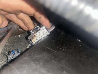

So I figured it out, my forgetful brain forgot to plug in the block temp sensor, and the front downstream 02 sensor. Now she runs smooth as silk and the temp goes up to half and stays there. No more bubbles no milkshake just bright greenish yellow coolant. Also found why my heated seats stopped working. Going to order the new pigtail connector on payday.
