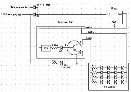

i wouldn't mind knowing how you built the PWM unit you have. thats what has always stopped me from doing it. mind sharing?? please please..

I actually bought two kits(one for each tail light for simpler wiring), i bought the kits from this place Quickar part number ML-804. Even though they are indeed kits which require only soldering to work, the type of transistor they use ,(PNP or NPN) not sure which it is, causes a problem when using dual mode(park light and brake light) the modification that needs to be done is to wiring the source from the brake switch into the trigger (base) of the transistor to over ride the Pulse width that is set and basically tell the circuit to go to 100% duty. If it is too hard to follow this description heres a pic;
Pwm rewire
This picture illustrates the parking function and brake function wired through a voltage regulator, this is what alot of people do when doing full retrofits instead of or on top of resistors. For example my setup, which is what a few others have run on hidplanet, regulates source voltage from battery voltage down to 9.8v and then run to strings of 4 leds (21 strings per tail light). Each led can handle 70ma of current which in strings of 4 leds with 9.8v source voltage is about how much current flows through each string.
This project boils down to being tedious not really too difficult, since pre made circuit boards go for hundreds of dollars my circuits were hand laid 24 gauge wire. This is the only thing that i didn't take a picture of. If one were to know how or learn how to solder it really isn't to hard to complete something like this, there are many of those over on hidplanet that have done led tail lights and many of which post pictures and circuit designs making easy to follow along and do similar setups. This is not to say you in particular Ohioshodude need too much help with electrical projects with the mods you have done to your gen I. lol.
