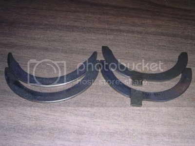

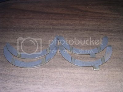

It says on his site that he doesn't sell those bearings anymore. The engine I have the bearings from had 54k miles on it. I will take pictures of them.

And in answer to your question: The grooves go toward the rotating parts, which is the crank. The oil comes out of the hole in the crank, squeezes through the space between the main bearing insert and the journal, then it squeezes through the grooves in the thrust washer. Since the crank is rubbing against these grooves, a nice layer of oil escapes and keeps the crank keeps the crank centered and slippery, right in the middle.
There is a limit to the acceptable wear that you can have. I don't have those specs at hand but I've never seen a set with any bad wear on them.
