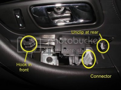

When a song with a lot of bass is playing, the window switch/lock panel on my driver's side door makes an annoying rattle. Anyone have this? Not sure how to fix it.

Clear silicone around the edges (quick fix)? Do you see a screw or screw cover retaining the trim panel? On the Edge it is pretty simple, maybe will work for the SHO too.
Window Control Switch
Removal and Installation
Edge only
Pull the switch bezel straight up to unclip it from the door trim panel.
MKX only
NOTE: LH front shown, all others similar.
Pull up on the front edge of the switch bezel and pull forward to unhook it from the door trim panel.
All vehicles
Disconnect the electrical connector(s).
Unclip the window control switch from the switch bezel.
To install, reverse the removal procedure.

The SHO is opposite of that. On the SHO (at least for 2011) you pop out the rearward end, lift, and slide backward to remove the switch panel.
Window switch
If you're positive this is the source of the rattle, I'd suggest some thin felt or similar between the switch and the door panel. Although considering the materials used on the mating surfaces, I question that they would rattle. Maybe when you get the switch panel out you'll see something more suspicious.
