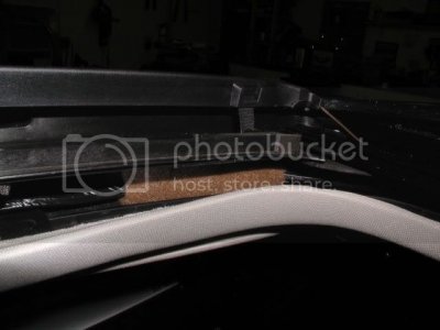

Well, after pulling the rear sunshade to fix a rattle there, then realizing that wasn't the rattle I was looking for and removing the passenger door panel, only to find that wasn't the rattle either, I think with Way2Evil's suggestion I was finally able to find the rattle!
Way2Evil suggested the rattle is probably coming from the passenger sun visor area. Sure enough, it was. I was able to open the sunroof completely, then release the headliner from the hook and loop fasteners just enough to see a wiring harness just laying on the top of the headliner. I could lift the harness and let it fall against the headliner which duplicated the sound I was searching for.
So, I rolled a piece of speaker box carpet over the harness and that appears to have quieted the rattle. Yippie!
Pasted below is an image of the harness with the carpet around it.
-Rod

So I was hearing just a slight rattle lately driving on a real rough stretch on I 40, sure enough saw this post and today when I could hear it i pushed upon the headliner in that area and it went away when pushing on it.

I originally thought that rattle was coming from the passenger door too, but found it quieted down by pushing up the passenger side sun visor. Thanks for letting me know what was causing the noise!
-Rod
Wireharness
SHOrod thanks for the photo! I took that in with the TSB for the rear decklid and the dealership was able to fix all of the rattling noises in the car! She's super quiet again!
Glad to hear that helped you out. Enjoy your quiet car!

Try pushing lightly on the headliner near the right front of the sunroof (photos above) and see if the rattle goes away. Something about this rattle, it telescopes all through the cabin and sounds like it's coming from anywhere but the headliner.
