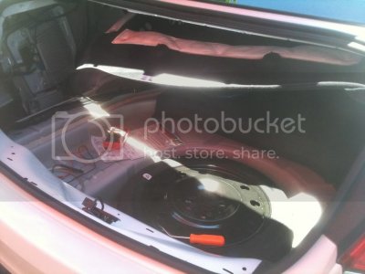

Start By Removing the Trunk interior Panels
IMG 3256
to start, lift the (trunk opening scuff plate) black plastic where the trunk latch is up towards the sky it will pop out fairly easily, next unscrew every sticking out plastic tab on the sides near the tail lights and the trunk net hooks now take a grommet removal tool and pry on every flat body panel grommet (some are very difficult to remove fully) you will also need to fold down the rear seats to access 2 grommets,

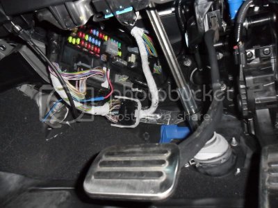

if you own an older model amplifier that requires a remote turn on 12 volt positive signal, under the steering wheel well above the brake pedal (way up in there) you will find a fuse box thats not easily accessible by anyone taller than 4'6 and a body contortionist ex upside down pole dancer, in your manual you will find a mini fuse labeled "delayed accessory fuse" this is where you will be adding a tap-a-fuse, add-a-circuit connector thing. run your remote wire to this :naughty:, for added safety i also added another low amperage inline fuse closer to the amp (do not use any fuses with more than 10 amps with any tap-a-fuse type of connector)

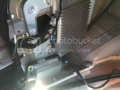

now to grab that audio signal...
don't touch anything here its hopeless :rofl:

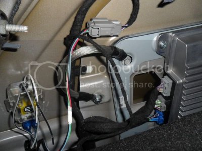

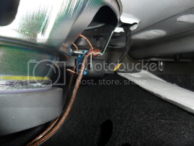

you will need to pull down on the liner covering the subs in the trunk, just pull down firmly, you will find velcro and a few useless body clips keeping it in place, take any line converter the best choice would be an Audiocontrol LC2i, i went with a Scosche 2 channe LOC80 rebranded as E2 at canadian tire which handles 80 watts per channel, wrapspeaker wire on the terminals of the factory subwoofers (this allows you to keep factory bass going, no neeed to splice any factory wire) now twist the other end of the speaker wire to the line converter wire and wrap with electrical tape or shrinkwrap (soldering would be awesome) now grab some 2 way adhevsive sticky tape and stick your line conveter somewhere onto the side (probably close to the tail light access flap screws so you can make adjustments down the road)

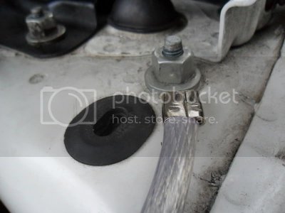

now to find a grounding location for that negative wire this is entirely up to you, some people sand a random metal spot and bolt it or if you were me, attach it to the grounding plate where the factory amp was :naughty:

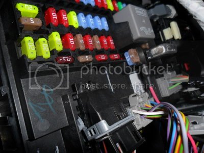

this is the fuse panel below the steering column where the add-a-circuit or tap a fuse is located
SAM 1732
to give you a better idea the red wire with the blue connector is the add-a-circuit

you may want to add another ground point for the battery to chassis connection
SAM 1736
although the rear grounding plate works well just for added safety i added another ground point using an M8 bolt with washer and nut you will need to sand down some paint for a proper ground.
you can also see the location of the line converter
SAM 1739
the line converter was added by twisting on wire to the factory speaker terminals (no splicing to any factory wiring was necessary)

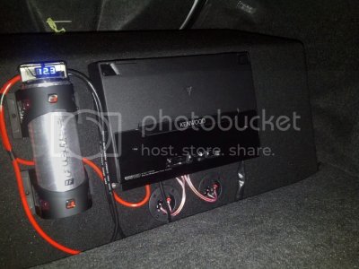

I removed my (2) 6.5" Bazooka Tubes and went with this instead. Now a little more room and A LOT more bass!! Just tie high level inputs to Left and Right rear door speakers. LR = White/Green Stripe (+), Brown/Yellow Stripe (-); RR = Brown/White Stripe (+), Brown/Blue Stripe (-). Anyone needing schematics, just let me know.
(2) 10" Polk Audio with a Kenwood 500x2 Watt amp wired at 2 Ohms. All speakers are still utilized with Sony system and navigation. 1 Farad capacitor to ease extra load on electrical system.
