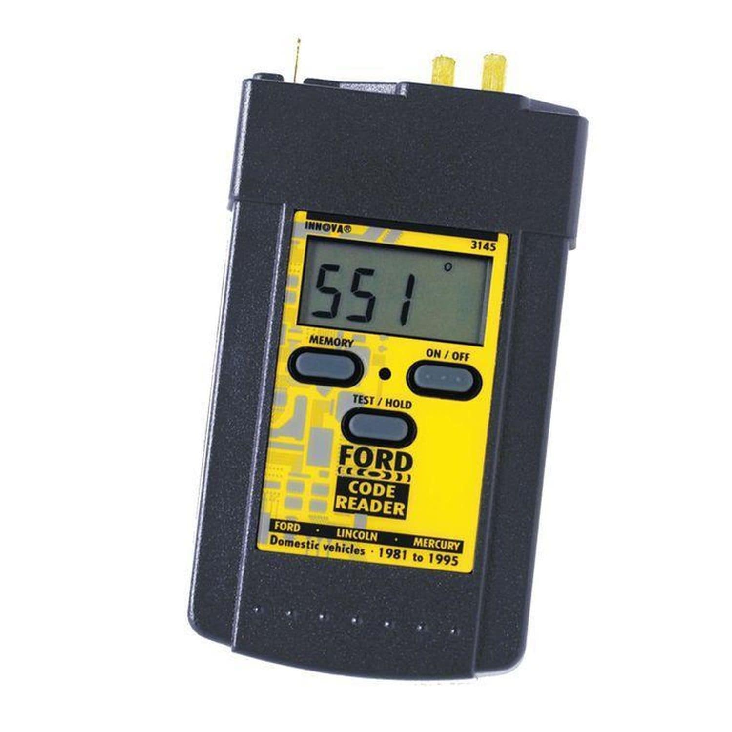

Do you have one of these? Makes reading codes a little easier than paperclip
Not sure how long it was sitting before I got it. Lots of leaves and dirt, but it was also under trees in the guy's driveway, so hard to say. I guess I do need to pull the codes, but I wasn't sure how much help they would be on the old OBD 1 system. Do they get into much detail, or is it more like "01 Engine Broken" level? The last pre-OBD 2 vehicle I had was an old 1992 Mercedes 300SL, and getting useful info out of that computer was like pulling horns off a jackalope. Does the tester offer more insight than the paper clip method? As to water leaks, I have not seen any evidence on the inside of the passenger compartment and the headliner is already pulled off the sunroof. Thanks for whatever help you can offer me. Still a bit of a learning curve with this car.

The code reader makes life easier as the unit will count the flashes and give you a number. This eliminates human error counting flashes and getting confused with pauses between flashes. It is, as you know, way different from obd 2 but it really can help point you the right direction and save time. Not pinpoint accurate but worth it a majority of the time

Well, I tried doing the counting method and you are correct that it makes it a challenge to keep the counts straight. As best as I could keep up, I got a 112, a 212, a 215, a 528, a 538, and a 552... maybe? I think maybe I should go run them again, only this time instead of trying to keep count and write them down live, maybe I will take a video on my phone and then go back afterward and try counting them that way so I can pause the video between individual codes.
