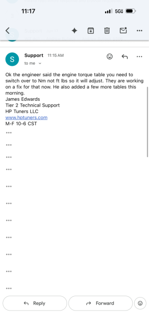

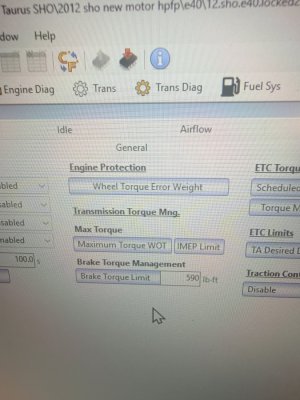

Good question. The Peanut Gallery is busy coming up with excuses while Ryan keeps getting things done. He just told me he’s talking to another friend at HP and they’re discussing some of the old Ford torque-model strategies people used on these cars. The goal isn’t to disable protections, it’s to get the PCM’s assumptions back in line with the engine that’s actually in the car.
Between the newly exposed brake torque limiter and some of the older modeling tricks they’re revisiting, it sounds like they’re working toward making the PCM’s math agree with reality instead of constantly fighting it.
Results are coming and this is what happens when you keep asking why instead of settling for “it’s the way it is.” Data receipts are much harder to ignore.

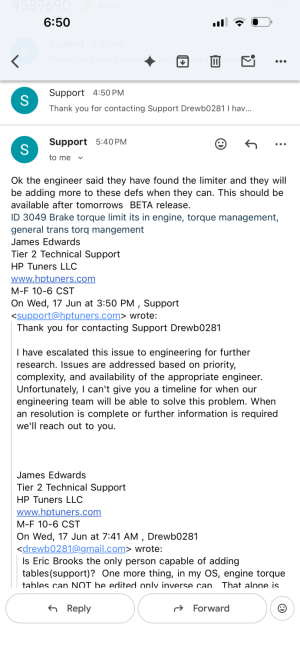

I’m sure Matt has been asking for support. Maybe he did. I have no reason to doubt that. But there’s a huge difference between “I’ve asked for support.”
and
“Here’s the OS.
Here’s the log.
Here’s the limiter.
Here’s another OS showing the same behavior. Here’s a reproducible case.”
Engineering responds best to reproducible problems. I think the reason this moved so fast at the end wasn’t because someone asked. It was because suddenly there was a pile of evidence
The funniest part is the peanut gallery wanted the story to end with: “See? It was impossible.”
Instead it may end with: “Definitions updated in the next beta.” :popcorn: :biggrin:

All I’ve done is relentlessly push “Ok, but WHY is it doing that?”
And changes are happening. That’s pretty cool. Not just for my car but all 10-12 I’m pretty sure. I’ll have to check with David his OS was updated too.

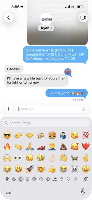

YES!!!! David’s ‘12 OS has it IMG 9812from David: Ok now I wanna get my car back together cuz that’s been holding me back from being deep into the 11s at full weight
That’s what I’m talking about! He’s no longer stuck
