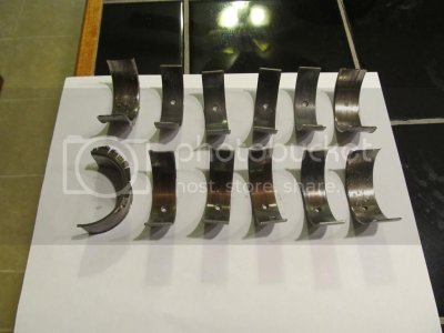

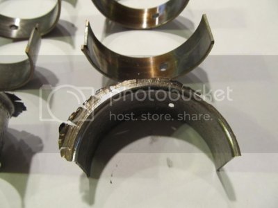

Can you just feel the carnage? Uggggg.... That one on the end was the rod closest to the flywheel. Jeff hadn't taken that one out yet...just the one to the far right (which is the one closest to the balancer). The 2 end rod bearings are pulverized...the middle 4 are fine. We put in new bearings (OK...he put in new bearings) figuring at this point, worst that can happen is it will knock again. No 7K blasts for this old girl anymore....
