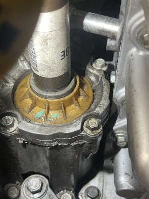

Was working on another car of mine today to use as a backup for now. Ill look at the sho closer soon. I did look for a minute today at the axel where it goes into the ptu and the white seal cover was still there and not leaking around it. But the exhaust is covered in oil under it. Still thinking it pushed the fluid out the top vent.

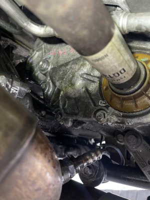

A friend of mine did his recently on the ground and said drop the exhaust. Pull the axle and unbolt the rear subframe to allow it to drop the rear. Not to sure if its something ill do myself or not. On the lift yesterday it looked pretty buried in there.
Thats weird i thought the updated ptu had a drain plug. That will suck if it dont. I really dont see the point in the pp one with a cooler. Just running amsoil in there or redline will be better. I dont have a cooler on mine and i never had it really overheat. Maybe just the message about it being fwd only mode but i just restart the car and it goes away on hard track driving
On my non zoomed in picture you can see my pretty cats.
The kid who got my car up on the lift. I asked him how my cats looked. And he just starred at them and said the cat thieves must be getting better that they replace the cats with pipes so people dont notice they stole them. Lol
D3B9BC4C D4CA 45F8 9258 B861B2698E28
yaycandy
Aerospace Engineer
Jul 2, 2018
2,612
2,003
Hanover, PA

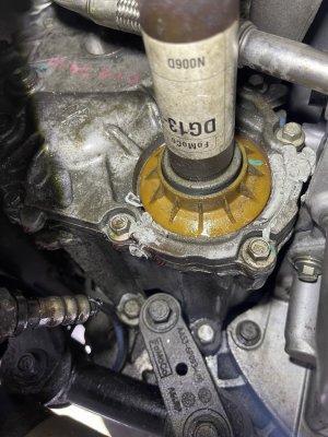

Up by the red lettering you can see a crack entirely across also. Broke her good. I went under it today to put silicone on the bottom crack so it can hold some oil while sitting in the garage. In case i need to move it and noticed it today. Hard to get light and camera in there

Actually started to smell that propane smell today. Yea i started driving it short distances. I drove it with a blown engine, i drove it with a blown ptu. I dont plan on driving it anymore now. I plan on replacing the ptu myself but now im thinking to just have my raceshop do the work for me so everything can be looked at better. Also you can see some red drips on the bottom of the ptu. Oil was black that came out. I put normal gear oil in it. Thinking thats atf leaking into the ptu now. So the inner seal at the 6f55 probably went also.

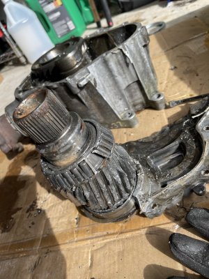

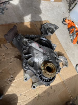

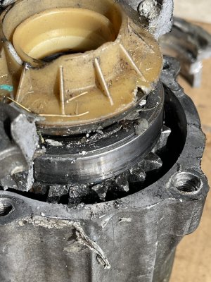

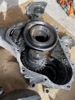

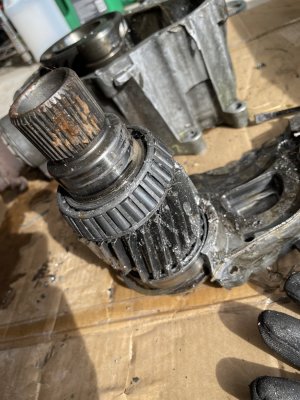

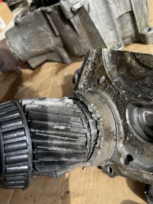

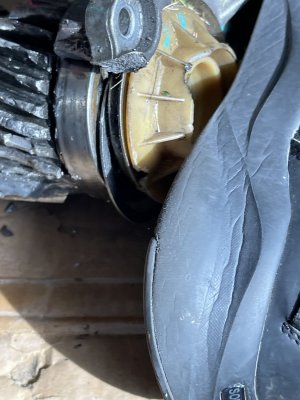

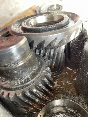

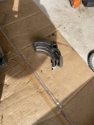

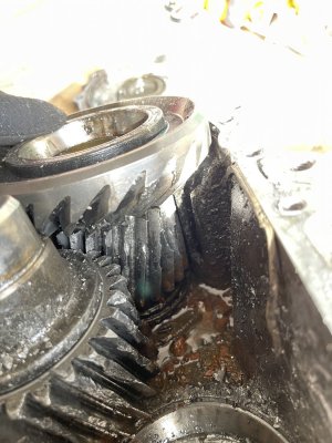

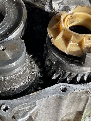

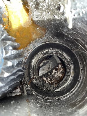

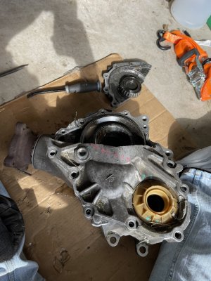

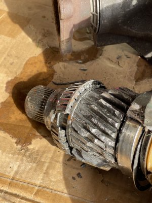

Finally got around to taking the ptu apart. I was pretty shocked by my findings. It did sit outside of my garage for alittle bit. Then i moved it inside my garage a little ago. So it was nice out today so i pryed it apart.
This will be a ton of pictures probably, i can put it back together and sell it for 100$ as gently used if anyone want it. Lol jk, but i will keep the bolts. Rest will go to the junk yard.
All i did was replace it and let it sit. Everything is what the car did to it
