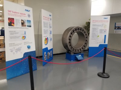

I work at SKF Aerospace. All government work with Pratt, GE and Rolls Royce. SKF purchased Kaydon Ring and Seal 10 years ago or so and thats what we do in this facility. All Kaydon work with their seals updating to SKF part numbers over time
yaycandy
Aerospace Engineer
Jul 2, 2018
2,613
2,005
Hanover, PA
We have components on Curiosity and the current rover and parts on James Webb space telescope. Along with the new contract for the next fighter jet fa xx along with the f135 contract

Skf Hanover manufactured the GE windmill bearings until the moved the production to Georgia in 2017. Each roller was around 120lbs.
