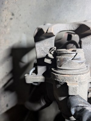

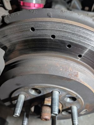

Also found this issue, which I believe contributed to yesterday's rear brake drag. At this point, I'm so frustrated I just want to get the new brakes on so I can drive it to a ship for a new right rear caliper (or rebuild) and have the rotor machined.

The piston must be screwed in to retract it. The slot on the piston must line up with the nub on the brake pad. Honestly, you need a new or rebuilt caliper and new brake rotor. No one turns rotors anymore. I know some do but, as cheap as rotors are, is it really worth it?

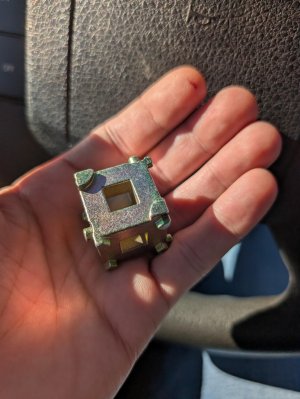

This little guy, right?

Ok, I've got the little cube tool and I can turn it now. I get maybe a quarter turn before it slips off, so my knuckles love this tool. After many turns, it still doesn't seem to be depressing. Am I supposed to be doing something else?

Well, you got the least effective and most fun to use tool. Press in while turning. Clockwise, IIRC.
This one?
That cube thing is . I'm going to see if I can return it. No amount of pressure (from me at least) will get that thing compressed. I'm doing good to keep it on while I turn it.

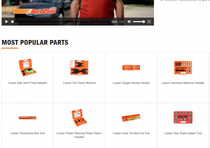

That will work. You should be able to borrow that from Autozone.
Thanks. For the price, I'd rather have my own. Amazon is bringing it today.

Changed my wife's oil and my RDU fluid after work. Amazon came through with the new tool.It's a game changer. It took 5 mins (4 of which was finding the right end piece and figuring out the tool) to depress the first piston. I can't believe I wasted hours last night.

Right rear brake piston boot / seal replaced, new caliper pins in the right/rear, new pin boots in the rear, new rear rotors (drilled/slotted), new rear brakes (front was replaced last month), and flushed the brake fluid with synthetic DOT 3 & 4.
