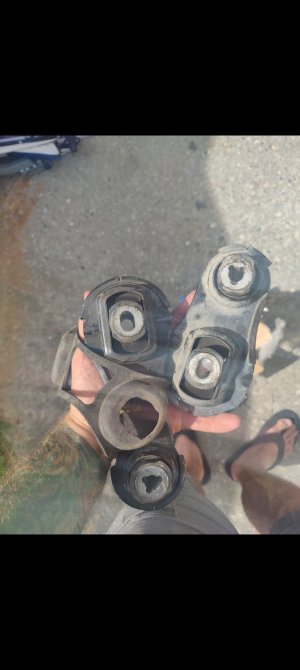

Swapped these out for the AD mounts. Was a bit of a pain in the butt, but got it done.
So far what I've noticed... Sounds louder/meaner in the cabin. I'm not mad at it. It also feels more analog in steering wheel with me. Can feel more vibration. It's not terrible but I definitely feel a little more of that rumblyness. It's idling right at around 5-600rpm so that might be doing it
Shifts feel smoother but wasn't able to truly get on it from a stop to try out a big 1-2 shift.
This car is starting to feel like a performance vehicle to me now. Next stop lower chin spoiler and lower engine splash shield replacement, have ordered whiteline sway bar that gets here tomorrow, and I got a good deal on some barely used bc coilovers as well. Waiting for my ppe downpipes to be made and shipped and will do intercooler and downpipes at the same time.
To be honest, I'm kind of tempted to try meth injection And do it at the same time as everything is going to be off for the IC and downpipes already. Thoughts?

I agree with your assessment of the feel spot on. that connected feeling I got over pretty quickly. yes most daily drivers would shiit if they felt the slight vibration, thus the sloppy mounts they install.
meth would be good but bang for buck and to address the heatsoak issues the IC. if you take my journey update the fuel system and and work toward e30. I am sure someone will argue its a cheap bang for the buck to go with meth.

Those mounts will break in and vibration will lessen. If you are tuned, go into the tuning device and raise your idle rpm by 100 -150 rpm and that will help as well.

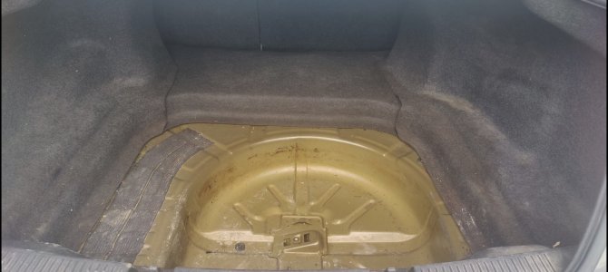

Slapped on new bottom engine shield and valance that it attaches to. Fixed all trunk leaks...

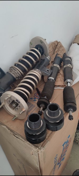

Bought a set of used bc racing coilovers with swift springs that had 4k miles on them and he was gracious enough to agree to ship to Alaska.
I am on the fence on if I want to wait to install these until after this upcoming winter.
Downpipes and intercooler too. I'm tempted to go for an E30 tune for summer months and buy a 55 gallon drum of torx.
I think that will just about conclude the work I would like to do in the near future.

Well, tell us the story.
Ugh. Usual culprits were leaking. Plugged the taillights, spoiler bolts etc. I found an actual seam was seeping as well as the top left trunk lid. I finally broke down and sat in trunk with waterhose going. I parked it nose down and plugged everything, then nose up and made sure everything was plugged. So far so good. I feel intimately familiar with this cars trunk. It's been the bane of my existence so I'm looking forward to driving this thing in the rain guilt free for a week, and then getting angry when it turns into a swimming pool again next time I check

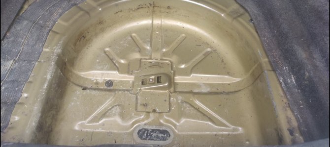

Forgot to show her in all her glory. Look at that. bone dry.
Debating on getting that piece that goes over spare tire well as that was absolutely thrashed by previous owner and waterlogged/moldy/crumbling. Would pay a fair amount in shipping to get that up here. Kinda seems like I could be putting more money into performance/maintenance instead.
