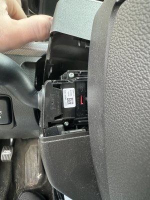

Wipers have been acting up recently and getting worse. Wouldnt fully turn off. Would stay at lowest intermittent. Ordered new switch on tasca and did it today. 5 mins. Clowns online make it out to be a harder job with pulling the steering wheel. Just turn it a bit. 2 7mm screws on bottom then 2 T10 holding the switch in. I guess ill see if its fixed or not. Time will tell.
So far today in the on and off thunderstorms it’s good.

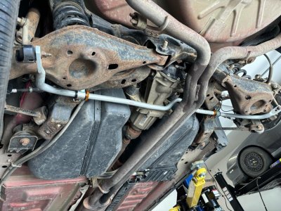

AD Gen2 trans mounts and Whiteline rear swaybar went in today, immediate shifting improvement with the mounts. So firm and *almost* completely fixed my wheel hop, some better tires might be in order to completely remove that. NVH in the cabin is very noticeable, but I love it, finally has some growl to go with its performance.
Ignore the rust, Canada things lol

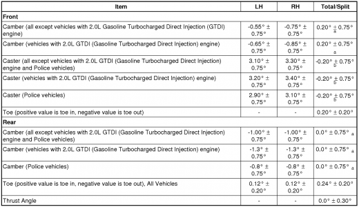

Replaced rear toe links, online claims the recall was performed and there were ford stickers on the parts but not sure why they were as bad as they were. both sides had a lot of movement, when i installed the new ones using the same measurements from the old ones the car crab walked hard. tape measure to the rescue, i set my "thrust angle" to about 1/32" toe in. anyone know if thats too much or too little? the car is ridiculously responsive now between new stickys and fresh toe links, not sure if its because I have them toed in too much or if the car is just supposed to be that good. not twitchy, just different from how i became used to. point and shoot handling with little to no body roll whereas before it felt more like a full size sedan

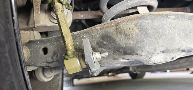

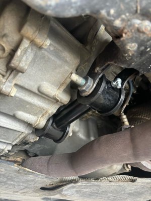

Got her new shoes finally put on this morning, so happy there, but starting last night I started noticing a clunking sound. Just got home and found the source, I recently installed the whiteline sway bar and some new Mevotech sway bar links, and it seems the end of the stud on the link is coming into contact with this lower arm. I'm guessing this means my install was not dine correctly. Any advice?
I found using the Whiteline sway there are two holes for firmness, use the more comfortable or outer hole at the end of the bar. If they used the snug setting I noticed it hits the chassis.

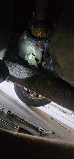

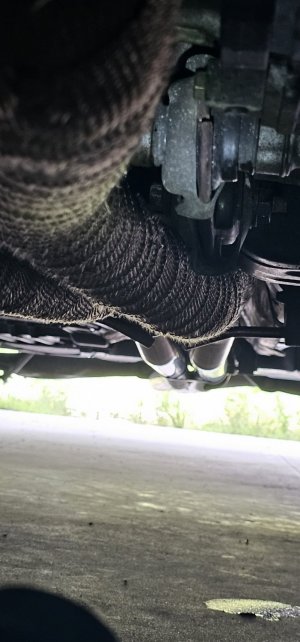

Thanks for the tip, she's free and clear now. Working on getting the rear trans mounts now, but still running into an issue with the downpipes. I was able to break the front bolt of the rear trans mount loose, but running the bolt into the downpipe as I loosen it. I did note another bolt above the transmount that broke loose pretty easily, but before I go ahead and remove it wanted to confirm with yall I'm not about to do something stupid here. Also I'm hoping by getting the front bolt off I'll be able to twist the mount and get better access to the rear bolt. What am I missing here, because I'm sure this was supposed to be pretty straight forward.
TheOGScooby
May 21, 2023
54
60
Southwest FL
Sorry photos didn't upload on 1st attempt
