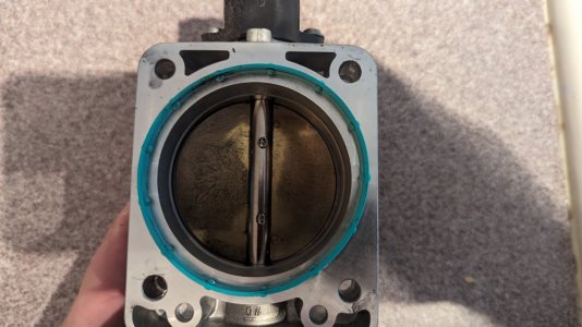

Yup the green one - I replaced mine during the swap. It is big enough to sit flush with the body and clearly larger than the TB hole. This pic is with the stock TB

I am more so talking about the lip of material on the intake manifold being enough to hold the gasket in place. You can knife edge it, but not really much material to remove.

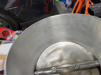

I looked up the throttle body in question. I can see what he is doing and yeah technically there is an increase in area that air can flow through. Kind of wonky to say though that the shaft removal is directly comparable to a diameter increase, but otherwise makes sense. (Cuz area of a circle gets quadratically bigger as more diameter is added) Other than the shaft removal the funnel he created is only going to add air flow to the throttle body plate if there is a restriction in that. Long story boring it'll flow more if there is a restriction, which I don't even think we really have and probably the part throttle performance difference is the fact that at a lower pedal position you are just opening more surface area, which arguably I guess you could change pedal sensitivity to get same effect, but wide open throttle is going to be the same either way. Sorry i get nerdy into the numbers with optimizations. This is a pretty recent topic for me as I was thinking about going back to the OEM throttle body on my single turbo build because I don't think it adds anything and disrupts air flow. Now..... If we were NA then I think this would be hawt and I did the same stuff on my NA Coyote truck.
Good pickup Jordan, look I didn't put much thought into it, a fellow forum member pointed it out and the Maxbore store is now gone. I was gonna take my TB and send it out, but they are no more.
I travel for work and will be out of town from this Sun through next week and will still need to log and get Brad's input, I know he is curious.

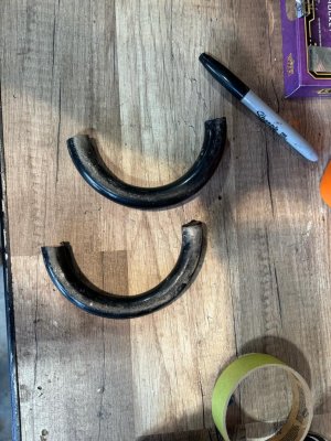

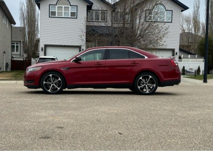

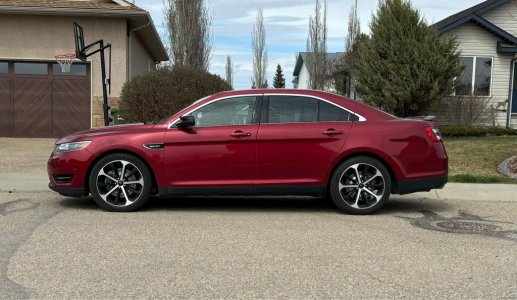

Cut the rear springs today for aesthetic levelling purposes. Couldn’t believe how simple it is, two bolts to swing the sway bar and a bolt on each side to drop the lower arm and the spring comes out. Cut off half a coil and it dropped it 7/8 of an inch. Almost level and it will probably settle as I drive.
There is a bit of a new clunk going over low-speed bumps. We made sure everything we touched was tightened back up, the spring and spring seals are in the same orientation as they were originally, and there was no play in the wheels. Did anyone else have these light clunks and do things just need to settle more? Otherwise love the look!

Looks great - I haven't heard anything using the H&R springs. Did you check the rear sway and make sure it's not running on the axle housing? Get under there without a jack on full weight. Also since the trunk is huge, you could step into the trunk and give it a good bounce test with another person listening.

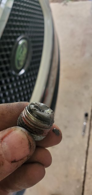

I've had mine for 9 months, supposedly the dealer did the ptu rdu around 85k but the plug looked like this
20240517 122335
Not sure if that's normal for a 30k interval but the fluid looked okay and I was pleasantly surprised to find the rdu exhaust hanger already cut. Either way it's done and now since I over bought all my fluids I can do it again next time much easier.

How many miles on her? She looks ok but what color was the gear oil? Is she a PI? Then they maintained it... Keep an eye on it, more frequent changes maybe as well.

She's at 115k, tried to hold it to the 30k interval it appeared it was regularly receiving according to the records (30k, 60k, 85k plus water pump and chains, sold at 87k). But that was a 1/4" blob of metal shavings on that plug so it worried me a bit.
Gear oil was cleaner than anything I saw on YouTube so that was a plus,
and not a PI she is a non pp SHO which made the day really fun extracting it all from the fill hole on the ptu.
Since I have the extra fluid I'll probably do another fluid change closer to the 20k mark and make it an annual thing.

Ok that's right, well keep the oil clean and watch how much builds up, might be a window for a replacement soon. No whining you are good for now.
