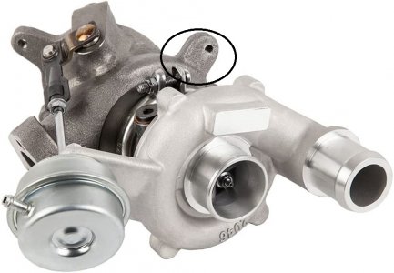

I believe the different casting numbers have to do with a brace that Ford removed. 2010 had a brace to the engine block. Sometime along the way, Ford decided it wasn't necessary. My 2016 did not have the brace or the boss for the brace on the housing. All replacement turbos have the boss for the brace so that only one left and one right part are needed for replacement. There is no difference in the cartridge.
If my is correct, this is the boss.

The number is stamped on the lighter-colored housing (cold) right where that flat spot is. Hopefully, it is just the boss and I can use the CHRA. It will save me $1k.

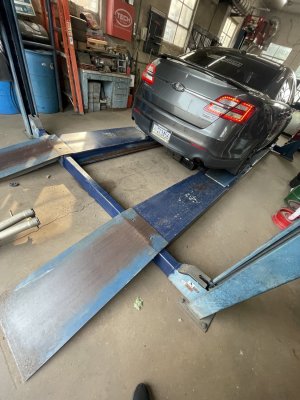

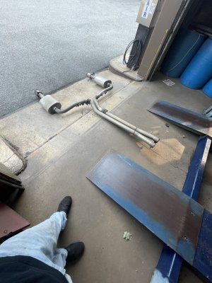

Went to my alignment today. Watched the guys take the sho up on the lift and watched my muffler system just fall off when the band clamps hit the cross bar of the lift. I laughed with the guy and said hey you got half way up the lift and now it sounds better lol
Just an omen that i should yank it all off and just run open downpipes again

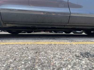

Funny my car is a PP - and I find the stock ride to bumpy - but handles for such a large vehicle. I will/want to lower my car - regardless if the ride gets more stiff. I love the look - and lower center of gravity. Concerned about leaving my exhaust on the edge of a lift like @yaycandy lol

My Corsa exhaust is about ~5 inches off the ground. You learn how to go over every bump on an angle.

My band clamp bolts hang lower so thats what hit at that angle pulling up onto the rack. Never had an issue anywhere else. They have a slope up to the bay door and then the slope to get up on the rack so it all mathed itself up. 2 half nuthings is a whole nuthing. Just on the wrong end of that whole nuthing
