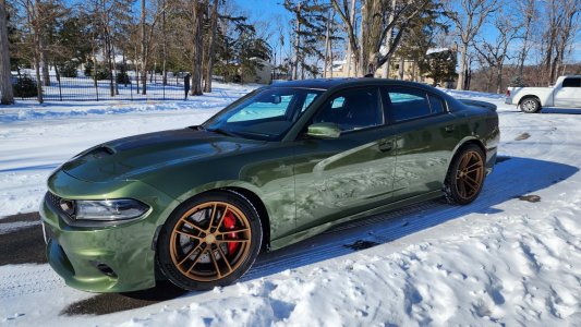

As much as I enjoyed my SHOs (have had 3) and MKS Ecoboost, I would often find myself drooling over the sound of a nice V8. My son and girlfriend finally talked me into getting a fun car with a V8 since I have my truck for the bad weather. So I traded the MKS in on a Dodge Charger Daytona 392. It's definitely a different beast from the MKS. As a 4-door though I can still consider it semi-practical.

I like the color

Dual overhead cam, twin turbo, direct injected V6 AWD vs large displacement old school pushrod V8 RWD. They couldn't be more opposite of each other.. :) Looks nice !

Very nice color. And, they do sound pretty great.
Let me know when you want to run em. ;)
Thanks. I'm not much of a "green" car person. The only other green car I've owned was my 1998 SHO. But I do like this color.
Since you list your best 1/4 mile time in your sig, you definitely have more experience than me and have achieved a faster ET than I've seen anyone achieve on the stock 392. I have 305s in the rear, but I still am pretty sure that won't make up for you having AWD. But I can come close and still have warranty coverage. :p
