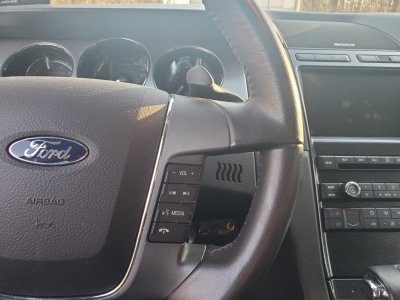

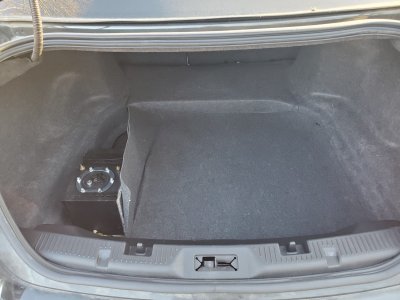

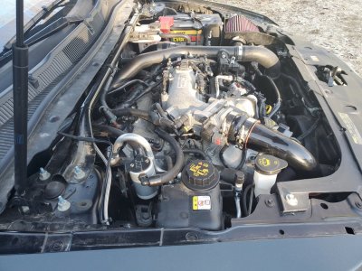

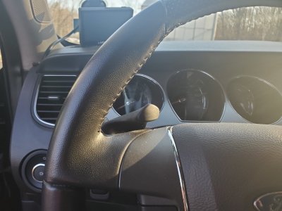

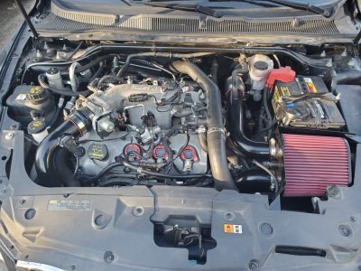

So it wasn't today but over the weekend me and my buddy did a custom trunk install for my alky control meth kit. The instructions were pretty good, but a little mixed up at times. We made it through no problem. All lines were dry and all electrical connections worked properly first try. Everything possible is hidden and tucked away. Run along the wiring bundle that runs from the rear down the driver's side door sills, then through the firewall by the brake pedal. Only things visible in cabin are the LED lights and mini controls. Still have to trim up the carpet in the trunk to go around the tank setup but that's it. I think it turned out pretty nice :cool: Time to start dialing it in!20220406 17565220220406 17553920220406 17574520220406 175216 20220406 175815

So it wasn't today but over the weekend me and my buddy did a custom trunk install for my alky control meth kit. The instructions were pretty good, but a little mixed up at times. We made it through no problem. All lines were dry and all electrical connections worked properly first try. Everything possible is hidden and tucked away. Run along the wiring bundle that runs from the rear down the driver's side door sills, then through the firewall by the brake pedal. Only things visible in cabin are the LED lights and mini controls. Still have to trim up the carpet in the trunk to go around the tank setup but that's it. I think it turned out pretty nice :cool: Time to start dialing it in!View attachment 83671View attachment 83672View attachment 83669View attachment 83673 View attachment 83670
Sick!! Nice job

Thanks bro! Only thing I may add is some black wire loom over the braided line to make it blend in even more under the hood. On the fence about it yet
I don't even notice it in the front pic, but someone's gonna accuse you of running nitrous with that SS line haha.
When I had my meth kit, I always wanted to build a false floor in the trunk with a trap door for tank access, it would keep you from having to trim the carpet should you ever decide to remove the kit and you can do it with some scrap wood and some plywood scraps.
Will also help should you have anything you need to put in the back you don't have to worry about it ramming into the tank.
Ta2dResqr
Dec 10, 2020
1,208
1,144
Central Ohio
Another option is to look into the Cargo Organizer. I have one in my car and it makes the center section level with the sides. Cut out a section from underneath to match your fuel cell. Just depends how much height you need.
