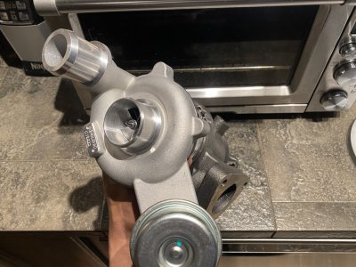

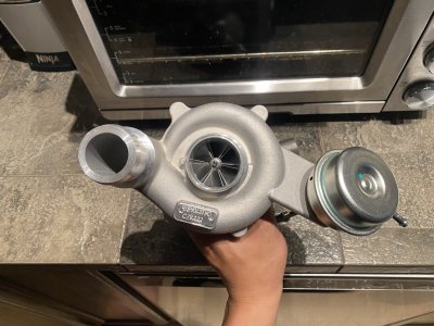

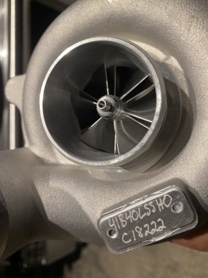

Ready to send a rod to space! Just waiting on my 13+ manifolds and misc lines/hardware. Wasn’t really planning on upgrading my turbos just yet but they decided to go bye bye sooner than I thought…

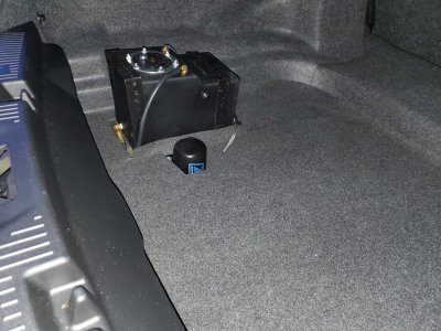

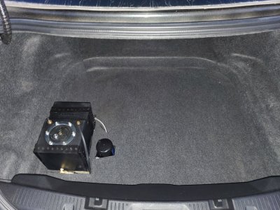

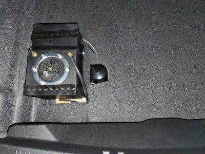

Finished fitting the carpet in the trunk around the pump and fuel cell for the alky methanol kit this afternoon. Very happy how this all turned out.

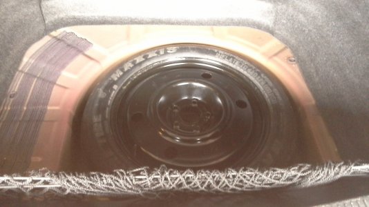

I went the OEM route for the noise maker delete as well and I'm happy with it so far.
Did you go with an Explorer spare or one from a non-PP? I have a 16 PP and want to put a spare in it at some point.
I see from another post you got the spare from an Explorer.

Yeah, the Explorer spare is only 1.5" shorter than stock while the non-PP is almost 3" shorter if I remember correctly.
