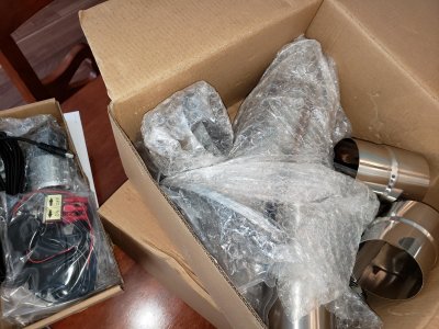

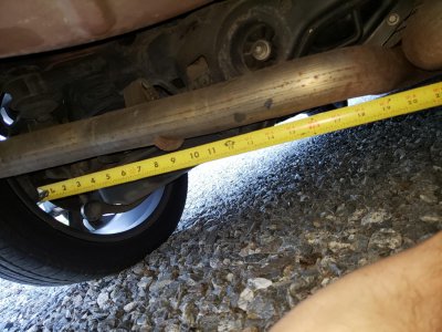

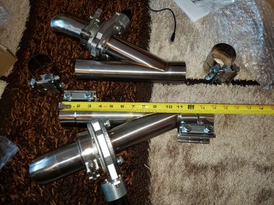

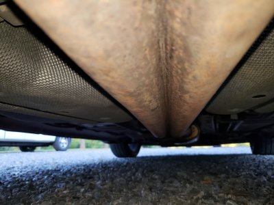

I guess I should've taken these measurements before I bought the parts... I don't see any way this is going to be a weekend/garage install. I have welded a time or two but I don't own one and wouldn't feel comfortable doing it even if a buddy let me borrow one.
Any suggestions before I send it to a shop? I'd like to keep it fairly quiet before I open the cut outs so I'd prefer to not buy an aftermarket exhaust. B5bf8c2a2cc7469471648e835bf455b6C2068b3cac407ea0171a6e862141c46bEddf073c47223b4773e0ebf31437087d

I'm pretty sure you can cut the cutoffs down as long as you keep the Y section and a couple inches on either side. You should be able to chop about 2 inches off of it on the long side if the length is bothering you. Maybe 4, depending on if you're counting on the clamps to hold your exhaust together. You wouldn't want them welding next to that mechanism, though, which is why it's so long.
I might not understand your concern ... it LOOKS (from my armchair) doable.

I agree with that. I was just trying to figure out how to do it at home without welding. The clamps are flanged so if I cut off any of the pipe on the Y I don't think I could use them. Oh well, I'll be less likely to have an exhaust leak if I have them cut and welded in.
The motors come off so that shouldn't be an issue for whoever welds them. I have them loosely screwed in for the picture.

Oh, I didn't notice flanges. I can understand the concern now. I would go on and get them welded, honestly, as long as it doesn't affect inspections or anything and you plan for them to be a permanent part of the car, just because of potential exhaust leaks.

Yea it shouldn't affect inspections. They also sent cap plates so if some inspector ever gave me a hard time, I could just remove the motors and cap them off temporarily.
