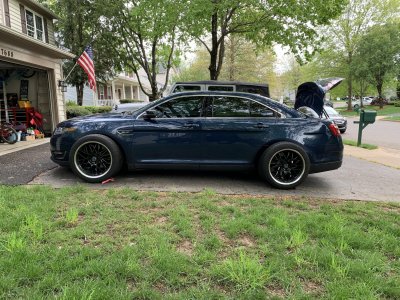

Finally found the official weight of these wheels through a dealer.. each of the Enkei Lusso 20x8.5x40offset with a the 5/114.3 pattern is 26.85lbs and the 255/45/20 Conti DWS are 29lbs vs the stock flowers which I believe are 32lbs and the stock perelli's are 32lbs.. that is a weight saving of 8.15lbs per corner if those numbers are accurate. That is a significant rotational savings plus I get almost .6" of additional tread contact..
Should get that 60ft down easier.

Looks a lot better. Before I did my trim and wheels, I got to a point I really didn't even like looking at my SHO anymore.
I was a hair away from trading it... thought maybe I should shake it up a bit before hitting the eject pod...
