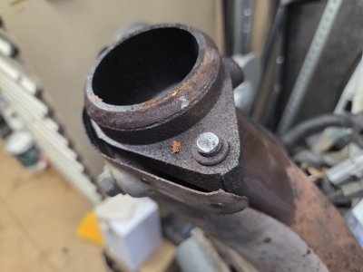

I just had to replace an exhaust stud on a client car. N811-284-S101
The professional way to do it is to weld a nut on the bottom of the stud. One still runs the risk of the stud snapping, however. Otherwise the best thing to do is to cut off the stud with a Dremel / cutting wheel, but leave 1/8" of the stud proud of the ******. Use the Dremel to get a flat surface.
No way to get a hammer in there with an ordinary punch. So get an automatic center punch such as this one from Grainger : https://tinyurl.com/yyfs778f
Start with a pilot drill, then go larger and larger until most of the stud is removed. Be prepared for the bits to jam. Best to just kiss the hole to stop that from happening. Once the stud walls have got fairly thin, try collapsing the remains in on itself with a hammer and small chisel. I made the mistake of grinding the stud flush with the ******, so couldn't do that, and had to go all the way to what was left in the pic. I have all sorts of bolt extractors, but they got me nowhere. I put an M10 * 1.5 helicoil in.
