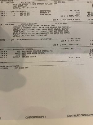

Went to update my latest tune from Gearhead and got the good old “Check Charging System” code and then was told the system was shutting down to go into battery saving mode..
Wonderful, luckily it decided to tell me while the tuner was still preparing to update tune...
Soo now it’s got the bigger 850 CC battery as opposed to the stock 650 CC battery. And since I don’t have forscan I had the dealer do it so they could reset the BMS...

And then receipt for reference if anyone needs parts numbers etc...

The battery saver message didnt mean your battery was bad at all. It just meant that the BCM thinks that its state of charge is low and will turn things off to prevent it from getting so low you cant start your car.
You can prevent that message when you have an extended key on time by connecting a battery charger to the car and making sure the negative clamp is connected to chasis ground. Use 15 or 20 amp charge rate.
The Battery Monitoring sensor is on the ground side of the cable and if it doesnt see charging curent it assumes the battery is being discharged. So you can still get this message with a charger connected to the battery terminals.
If you had a charging system DTC, I rarely see those resolved with a battery. Usually the battery is an affect, not a cause.
This
So many times I get customers with this kind of complaint.
The alternator will start to go bad or connections and start to **** the battery. Well, ******* customer thinks it's cool to just deep cycle a battery and jump it repeatedly. Totally the battery. ‍♂️
They think that the simple fact the battery is dead...means that's the cause.
Yup, 100% agree with what you said... however...
1: It’s a 2016 with a 2015 build date with the original 650CC battery. Wouldn’t be unheard of for the battery to be on its way out.
2: It wasn’t an extended key on issue. As the message would pop up within 90 seconds of going into accessory mode.
3: After a 45 minutes drive, I had the same issue.
4: The car wasn’t cranking over as clean as it used too.. hard starts.
5: I don’t daily this car... it spends a significant amount of time sitting in my garage collecting dust.. which is ******* batteries especially during the winter time.
All the above is classic symptoms of a dying battery. I asked Ford to check the alternator since it was there and they said alt was good.
Since getting the new battery the car starts quickly, I can flash tunes, and I don’t get the battery message...
Granted, it could be another issue and a fresh battery is covering it up... but thus far there is no indication that’s the case.

That’s kinda funny, last year my ‘14 SHO battery died. And just yesterday the battery in my ‘15 Edge gave up. I guess five years is the limit. No warning on either. Just one day decide to strand you. I remember 20 years ago nursing a slow crank for months. Hahaha.

Yep SBS, these cars eat batteries. I know for a fact that my car has gone through three batteries in seven years. Since my isn't a daily anymore either, I keep mine on a battery tender at all times. This also helps when I "prime" start my car when it sits more then 5 days at a time, which has been a lot lately.
