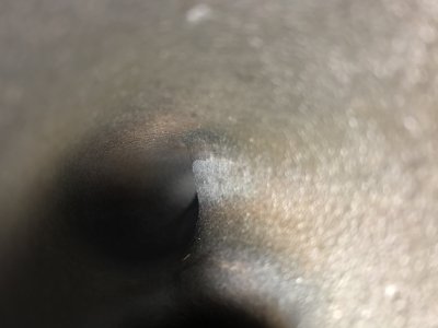

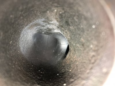

Have Mike check over the turbine housings for cracks. Might cause issues down the road. No clue on the upgraded turbos being prone to cracks but my 10k mile oem set definitely were boogered.
Ecoboost_xsport
Mar 21, 2020
2,039
3,945
Sacramento, CA
Have Mike check over the turbine housings for cracks. Might cause issues down the road. No clue on the upgraded turbos being prone to cracks but my 10k mile set definitely were boogered.
Yup, it's a common issue. ATP says they see it all the time. These were mine, and they only had 25K miles on them at the time.3bb9167d1b5210da7c0558ab8f837e1aDe68ded60b7ac4367e2b0d204717fae7
Edit: not referring to the ATPs, but the stockers, which may not be relevant here, lol
