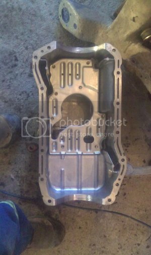

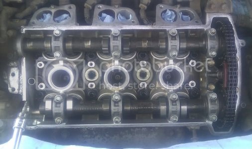

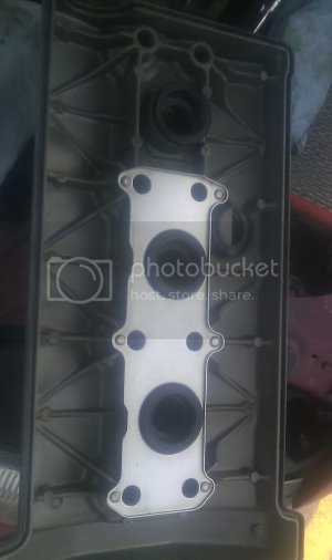

Couple picture of the rod bearings @ ~193,000 km (120,k miles)
B1
B3
Engine still clean @ 223,000 KM (138k ish miles)
IMAG0211
IMAG0391
IMAG0398
Not sure what oil you guys are using to get that gross baked on brown coating.. but I've been running Castrol Syntec in my SHO since I've got it, and it seems to be keeping everything mint.
