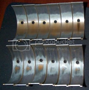

thankfully I know I put the oil pickup tube back on.....lol
how many miles are on yours???? they look alot worse than mine.
mine only had wear on the rod side

120,000 miles.
I was hoping it had been done before I bought the car... but it was obvious the exhaust had never been touched before. so I bought a set of bearings as insurance in case I started to hear any noise / loss of oil pressure.
All of my wear was also on the rod side, the cap side had a little bit of wear, but for most of them they were not down to copper yet.

heres what mine looked like for comparison... look a lot worse then yours I think
151k miles 93 mtx

Wow. See why I don't want to fool with mine now. What's the success rate of changing out the bearings after the engine starts tapping and not ruining the engine? I have heard some sound far worse than mine.
