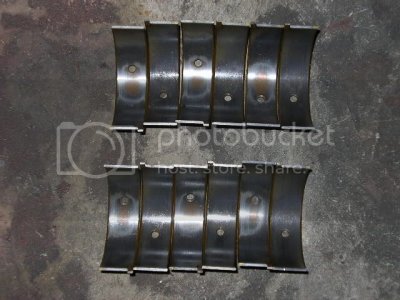

here is what happens when you use synthetic Amsoil in your SHO for 70k
only two oil changes in 70k, car has 130k total, Im sure any oil wont protect rod bearings when
the engine is abused like I abuse this yamaha, but Im impressed with the results.
the crank had absolute no wear with the bearings shown.
as much as some may slam what I use for lubrication, I still use this oil, never
to spend any more money for petrolium oil in any vehicle I use ever again.
I posted a few other interresting pics also.

For 70,000 miles, those bearings don't look that great. If those bearings are paired as they seem to be in the picture, then the journal for the first pair has a problem or a bunch of dirt or debris was pulled through the oiling system.
I'm sure there is nothing wrong with your oil and the oil remaining in your oil pan looks pretty fresh, but if you drive a car really hard as you say you do, try changing the oil more often. Oil changes are cheap protection.
I agree those bearings look great for only two oil changes in 70 K miles, but what would they look like if you changed it every 7,000 miles?

Those bearings are no poster child for Amsoil.
And changing the oil every 30K+ is a terrible practice, regardless of which oil you use.

The rod bearing I pulled from my 3.0 at 160k with very spotty oil change history looked WAY better than that. I would stick with good dyno oil changed every 3 to 5k miles based on those pics.

Actually, if I understand it correctly... 35k per oil change, they don't look that bad. Remember guys, I spun a bearing with Mobil 1 Synth on my own cars at 74k & at 105k on my 2 95's, both w/ synth changed at 3k miles.
When I blew the 95 ATX's engine at 120k at Road Atlanta (basically 45 minutes straight at WOT / 6k rpms), and the connecting rod shot through the pan, I'd been running Amsoil since the spin at 105k. The wrist pin was broken but clean w/o burn marks, as was the mangled connecting rod. The crank & bearings were clean as well - mechanical failure on the rod bolt was the diagnosis.
I've seen that kind of wear on some SHOs at normal mileage before (~100k). For 10X normal oil change intervals, that's not that bad.

Mine looked like it has been using awful oil, and has 138k on it.... The bearings looked way better.
I think your bearings look poor to be honest.

Actually, it was on because of those torn up bearings.
At idle the volume of oil flow is very low, so is the pressure. With huge clearances between the crank journals and the bearings, there is very little restriction for the flow of oil.
I picked up my SHO with 90k on it. At 105k, I swapped the bearings. It had been a track driven car, went thru 4 clutches before I got it, and had NOT been driven easy. From the records the car had always used crap "discount" oil. But they were regular changes, ranging from 3k-5k changes.
For referrence, here are mine at 105k:
I think your rod bearings look like garbage. The pan on the other hand, looks excellent.
