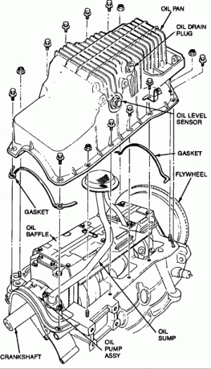

OK, I got that bolt, and all of the others off, but now I still can't make the oil pan move even a little bit (I tried a pry bar between it and the sub frame). I can see rtv spilling out the edge, is it possible that it would be glued to the block with rtv?
7,521
Yes, its glued w/ rtv - the seals only run at the front and rear end of the pan, the rest is just rtv'd on. Just make sure you have all the bolts off before you pry on it- normally it doesn't take that much to get it to pop loose.

I got the oil pan off but using a pry bar between the "wing" and the half-shaft. It didn't need as much force as I thought. And the phoenix project how-to way over states the difficulty of removing the oil pan, once I had the rtv loose, it only took 2-3 minuets to get it around the strainer and cv joint.
The question I have now is, how do I get the rod cap off? I wanted to check the infamous cylinder 5 while I am still waiting for the rod bearing kit, so I got the nuts off easily enough, but I cant get the cap to budge. I tried tapping it with a piece of soft wood and I can see it rocking back and forth a tiny bit but it never really goes anywhere. I don't want to stick anything in the gap between the cap and the rod and pry it apart.
