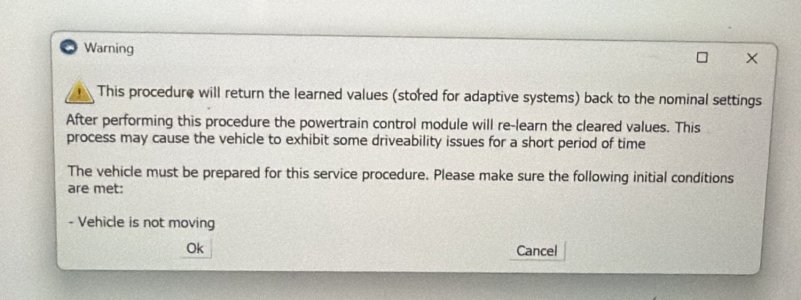

Ok an update. I’m thinking to use Forscan to do a crank relearn and KAM reset. Then retest Ryan’s ReV8 file. Turns out Eric Brooks, the lead Ford Engineer and developer for HP is the one who has my file. That’s pretty awesome. IMG 0282IMG 0283IMG 0284IMG 0285

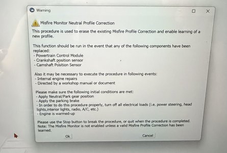

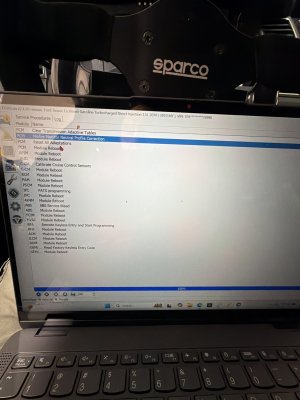

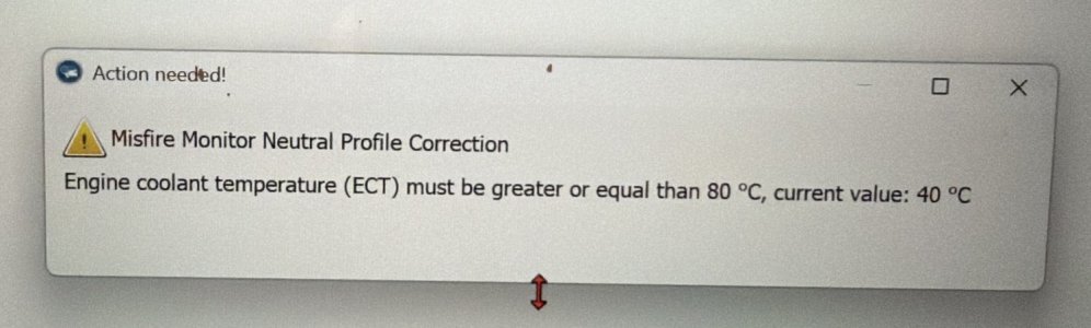

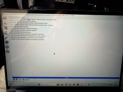

Last night was a partial success. The forever revolving door of checks and tests. Full circle back to the crank relearn process. I gave up too easy when I found for my OS in HP, VCM Scanner doesn’t list any special vehicle functions for me. Until I realized…oh yeah I can use Forscan…which is likely better anyway…
Yeah….this procedure carries real weight. Just read what the criteria is. IMG 0294
-built engine
-new crank sensor
Those 2 are perfect reasons. IMG 8BC9241B 4127 4136 9A37 866DE650FC48IMG 282EBF84 B794 4BEE A7B9 41174CF1A7F0IMG 0298IMG 451B51DB 1A53 46B5 B018 6E2CBECA01B0IMG 4BABB7E3 9DAD 4C18 8E3E 9480B1914931IMG FC671FFF 18D8 44A3 AA41 65C44FD46267
Yes…….essentially I introduced the PCM to the literal engine in the engine bay for the first time and then wiped the PCM’s learned memory.
And the car instantly rewarded me. Low speed, low load-moderate load shifts? Synchronized! Clean! Exhaust note? Crisp like as if beside it was mono now it’s in Stereo. Drivability restored. And it felt spicy doing moderate stuff. I was trying hard to stay objective but every time I had to come to a stop and go, every time I gave it a little it consistently rewarded me.
It didn’t improve a few shifts, it improved every shift. It felt coherent, it felt drivable. It felt synchronized. I even got a taste of one of the most beautiful mechanical moments, a 2nd gear downshift from 3rd as I was slowing down and it felt like it was perfectly rpm matched…like butter. No joke I went from guarded but happy…wondering if it would mess up once or twice to…relying on it to be perfect and it didn’t let me down.
