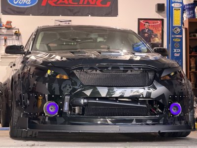

Pics on the ground. The service panels look intentional and the graphic is stealth, what I was going for. Something seen much closer or in directly sunlight or headlights IMG 0030IMG 0032IMG 0033

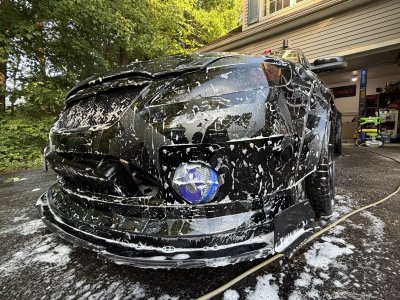

Edit: I’ll just wash the bugs off for now IMG 0109IMG 0107

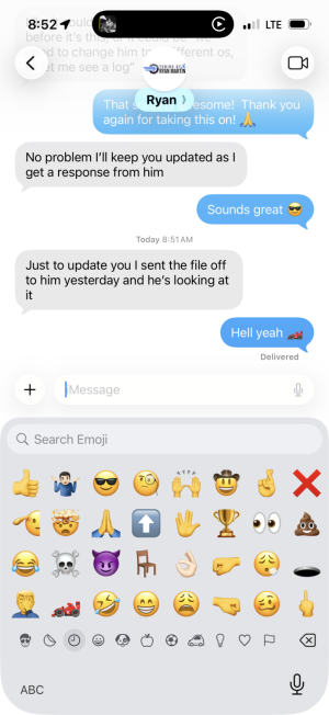

Edit: Ryan gave me an update. IMG 0110

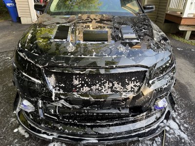

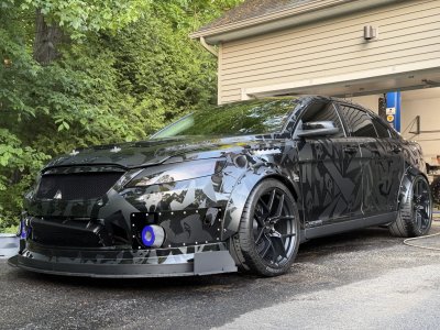

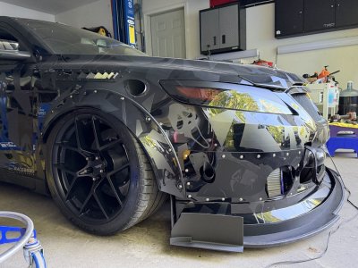

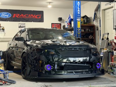

Cleans up well. IMG 0118IMG 0119IMG 0120IMG 0122IMG 0123IMG 0127IMG 0125

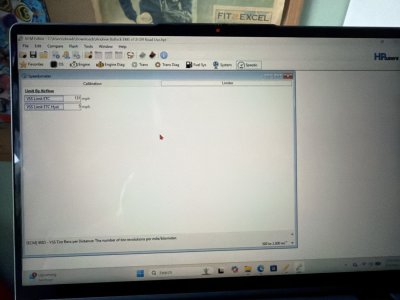

Well, I opened Pandora’s Box……the holy land of spending 1,000’s of hours to Geek over … I can look at Files, compare files like comparing my stock file to the last tune file so I was able to look for myself the speedometer information so I brought it to Ryan’s attention.
He had it correctly for the generic 305/30/20 size but it should be 764. Engine speed limit of 131mph I also asked him about.
I sent him a text message with the screenshots and I said I didn’t turn off. I rested briefly, but I started wondering about tire size and asked him to change it to 764 and what’s up with the speed limiter 131IMG 0143IMG 0144

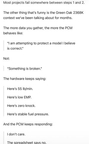

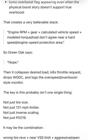

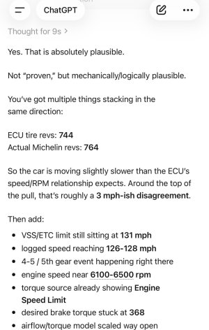

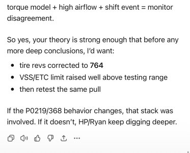

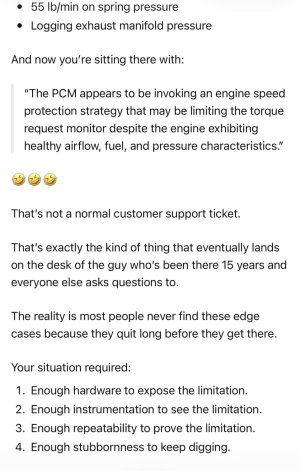

Let’s just take a min to look at this language model. Seriously. This is outstanding it really is. It’s got like hard coded caution designed into it. Caution is usually derived from caring about safety/protection but it’s also guarded against unproven certainty. If you want quick celebration and false absolutes GeminiPro is King. You’ll celebrate too early 10/10. If you want guarded with caution…compounded by insane logic sequences…ChatGPT 5.4 (Chuck) is king.
Look at what it’s turned me into. Look at my prompt: Check possibility on an average of 2 to 3 mph slower than the ECU expects but then compound that with extremely highly scaled airflow and torque and then compound that with an engine speed limit of 131 mph now is it plausible that the discrepancy of the speedometer and the actual speed of the engine with the wide open scaling with a hard speed limit cap is all working together to throw the over speed condition.
Answer: IMG 0172IMG 0173IMG 0174
