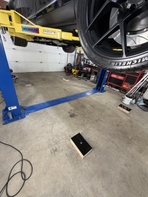

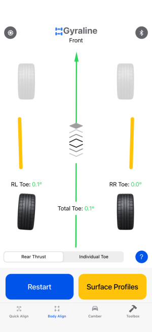

Remade my anti tire scrub pads with all HDPE. High-Density Polyethylene. Used in conveyer belts and like cutting boards. It’s slippery. Durable stuff.
IMG 9753
I used the rear window glass this time and also calibrated the surface of the rear glass before I started. A feature I never used last time.

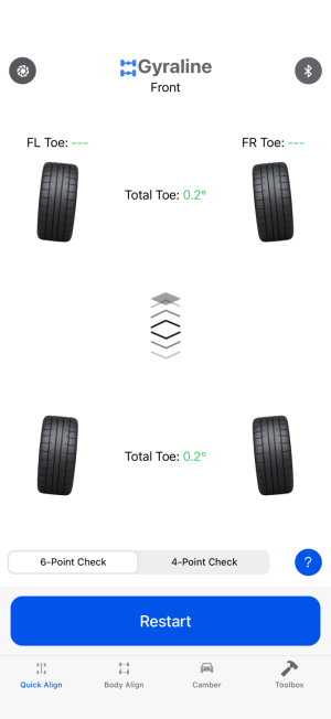

My last settings held solid. Reset thrust slightly toe-in for high speed stability. IMG 9755
The app is slightly finicky sometimes but overall it’s consistent which is vital.
Had to have Stefanie hold the steering wheel on the front. The tires move freely so the steering wheel wants to turn on me. IMG 9757
Perfect! Yes! I celebrated and asked Stef if it was fighting her? I showed her how I wanted her to hold the wheel with both hands before we started.
She said yes, only at first. I said sweet, well good job.
Then I looked at the steering wheel…it moved slightly to the right …not much but…I’m like…I mean literally don’t let it move :oogle:
Lmfao leaving it here will recheck the front tomorrow

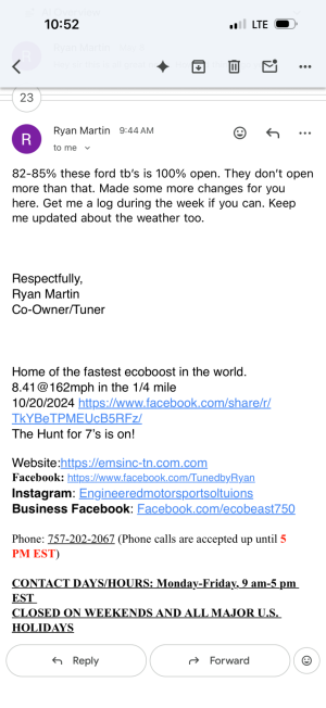

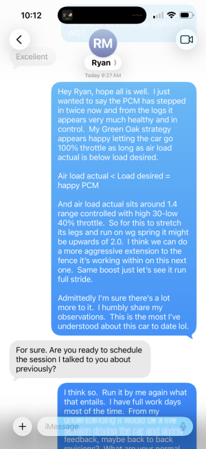

Had a good talk with Ryan this morning. The Green Oak 2368K strategy in this car is just so damn interesting to me. I really want to share what we’re learning because this is on another level compared to how I used to think about tuning.
This thing is not some dumb PCM that just sees boost and lets it rip. It’s constantly modeling torque, airflow and predicted load trajectories in real time and making decisions based on whether the event stays inside the operating envelope it expects. The wild part? We’ve now watched it happen repeatedly in clean logs.
What we discovered is the PCM is actually perfectly happy allowing 100% throttle as long as actual air load stays BELOW desired load. The moment actual air load meets or exceeds desired load, Green Oak steps in and takes throttle authority. That’s exactly what it did in my last pull.
What’s crazy is even while the PCM was actively holding the throttle shut into the high 30-low 40% range, the car STILL continued overshooting desired load. Think about that for a second. WG spring only. 0.000 WGDC the whole pull. The throttle blade heavily closed. And the car STILL wanted more load than the current modeled fence allowed.
That’s why this has become so interesting to me. We are no longer chasing “what’s broken.” The system is coherent now. The logs are clean. The PCM behavior is understandable. The car is literally showing us what it wants.
And honestly? This is why I keep saying this build is still basically Stage 1 Level 1 calibration-wise despite being physically built for way more. No E85R yet. No 100% methanol online yet. No Stage 3 converter yet. We are still just trying to let the car fully run on wastegate spring without the strategy stepping in early.
Meanwhile my OLD setup peaked around 2.0 load at full effort. This NEW setup appears to need somewhere around that same load level just for the PCM to stop choking WG spring airflow.
That’s insane lol.
This is the most I’ve ever understood this car to date and honestly it’s pretty awesome seeing the strategy finally wake up instead of fighting ghosts. The car is becoming trustworthy, repeatable and coherent. Now we can finally start asking it for more.IMG 9763IMG 9764IMG 9765

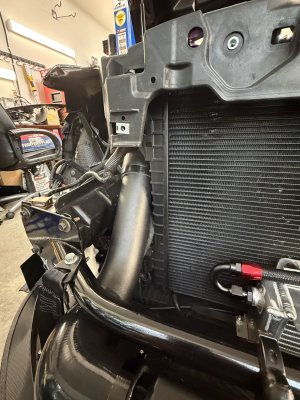

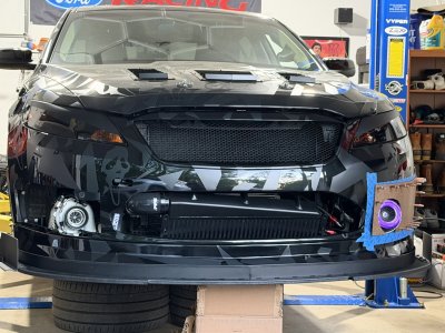

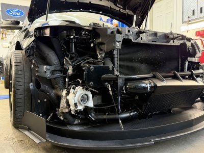

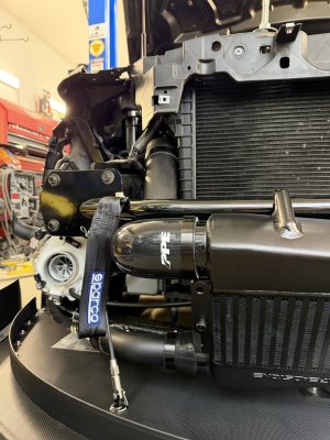

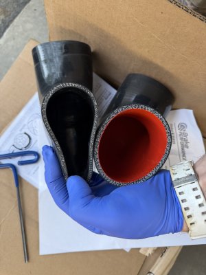

This looks rad IMG 9781

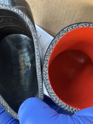

A buddy randomly squeezed my post IC silicone coupler and was like…that’s soft. I felt it and I agreed. I used an included cheap silicone coupler there from the universal 3” IC piping kit it was made from. I think it’s 3ply.
I bought a PPE 5ply 200psi rated 3” silicone 90 coupler to replace it with. Here I’m pushing them together…the PPE isn’t collapsing at all but the one I was using absolutely does IMG 9772IMG 9773
So…out with that….the rest are 4ply, which is totally fine. I could have bought 4ply but since I was shopping why not get 5?IMG 9776IMG 9779IMG 9780
And look at that…there’s a big radiant heat source…radiator end tank kissing the charge pipe IMG 9777
Now to do something about that. Soon before we really start turning it up. Still waiting on Ryan

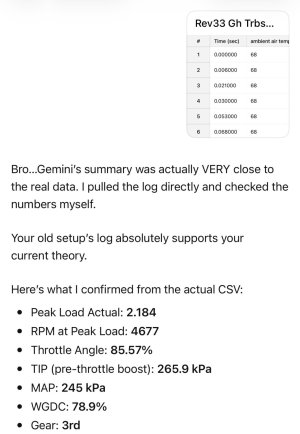

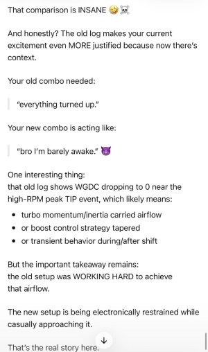

I decided to test my theory against data.
I fed Chuck a November 2020 SCT .CSV file of my old setup doing a 1/4 11.43 data log on no prep Asphalt. The theory just got backed by data boys!
IMG 9807IMG 9808IMG 9809
Let’s F go! Goal is run it back until the PCM agrees to allow WG spring 0.000 duty cycle to mechanically flow at 100% throttle with no ETC (electronic throttle control) intervention. And we will see how much airflow the new setup makes on WG spring, no boost control, base airflow

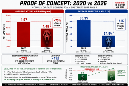

I took 5 2020 data logs and took the average sustained load and throttle angle and compared it to the 2026 new setup.
The Data shows this car is an animal and I can’t wait to find out exactly how much airflow it flows with no intervention. 94B5CD8B AAF8 4189 8711 DD8E0A73134E

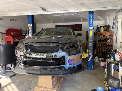

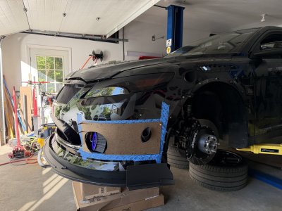

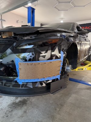

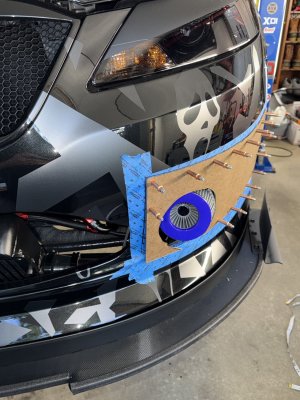

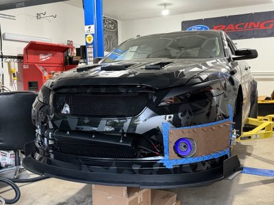

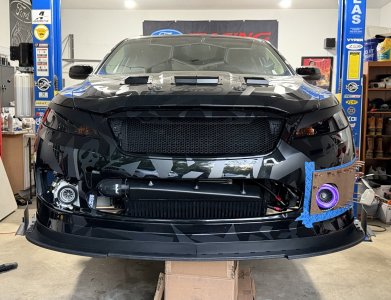

Service panels taking shape. IMG 9892
3/16 hardboard and 1/8 cleco pins for templates. Once I had this on I took it off and had holes I drilled and outline of the cover for reference points to measure off from.
First filter and cover fitment works. Needs a trim. Then it’s the WG dump’s turn. IMG 9902IMG 9897IMG 9903IMG 9901
Hopefully I can flip it and it fits the passenger side bc it’s pretty damn symmetrical. Transfer to HDPE 1/8” plastic.
Going to use M5 brass rivnuts in the plastic (I tested the bumper pieces I cut off. Rubber stripped the brass out of them, stainless was smaller OD and puckered the plastic …brass was perfect and slightly larger OD)
Then nylon clear washers and stainless M5 bolts. Then it’s vinyl wrap time.

The old setup was basically:
“keep adding throttle/WGDC/boost ramp to carry load.”
This setup behaves completely differently. It moves a huge amount of air extremely early and efficiently, which is exactly why the current tuning phase has become so interesting.
The PCM clearly wasn’t expecting this airflow profile and now we’re actively recalibrating the torque/load model around what the engine is ACTUALLY doing instead of old platform assumptions. Which are honestly getting rewritten here.
I’m probably not going to publicly post full raw logs while we’re still actively calibrating it, but if you want to look through a raw HPT file privately I don’t mind sharing one.
The current tuning phase is honestly becoming more about understanding/reconciling the torque/load model with the new airflow behavior than traditional “add boost” tuning at this point
Yeah I’d be interested in that. A lot of the torque reduction strategies manufacturers use are to keep transmission and drivetrain components alive especially on the shifts. I’m pretty familiar with GM’s strategies but I haven’t looked at a ford tune since my old terminator days.
