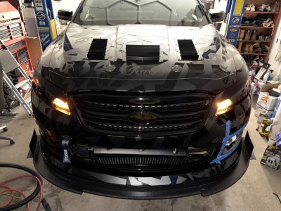

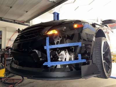

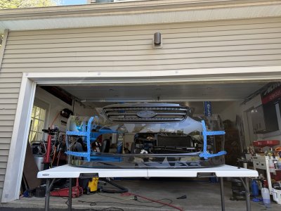

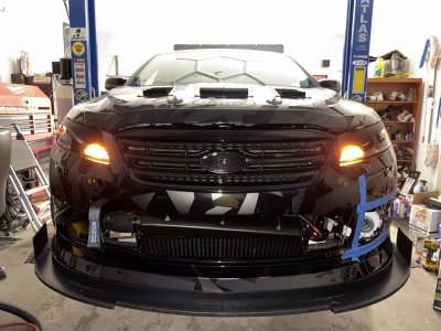

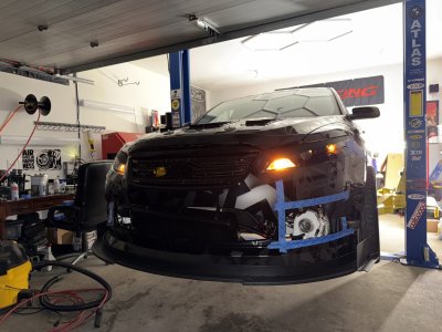

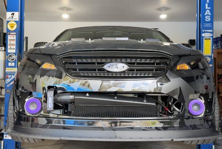

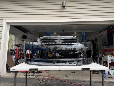

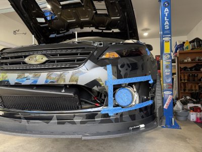

Hmmmmm….all alerts were going off in my head…you are about to cut your bumper what are you doing??!
IMG 9651
Yup…F it.
IMG 9656IMG 9657IMG 9658IMG 9659IMG 9660
Why does this look good with the OEM style grille? May just put my custom Paul Rand Ford Emblem on this.
More trimming required. Air filters are in the way to put the bumper on. I have to slip it in behind the Racebred air dam. I can’t really reach the front 2 carbon rods quick releases with the bumper on…unless I moved them to attach out front. Ideally the chassis splitter goes on last and comes off first. This way, chassis splitter stays on, remove air filters and WG dumps. Fit the front of the chin spoiler in the Air dam, tilt it back 45 degrees and then lay it in. Attach and fasten bumper. Add back air filters and WG dumps through massive openings. Then bolt panel covers back on.
Not sure on cover design, fasteners, all plastic or part mesh….its freestyle. Figure it out as I go
