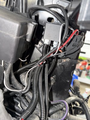

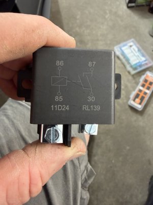

One electrical project I’ve been meaning to do for a while was properly rewire my single Mishimoto fan setup.IMG 9562IMG 24056CC0 18CA 4DC8 965C D58AF2D18B10
Previously the fan was powered directly through the switch panel itself. It technically worked, but cooling fans are a high inrush inductive load and every time the fan kicked on you could feel the electrical hit through the system. The fan motor startup surge was being absorbed directly through the switch panel and its internal MOSFET circuitry instead of the switch panel simply commanding the fan on.
Now the setup is properly isolated.
The Mishimoto fan uses 14g leads which I stepped into 10g wiring for the run to the relay. The switch panel now only sends a small 16g trigger signal to a dedicated 75A relay while the actual fan current comes directly from 30A fused battery power. Fan ground is also directly tied to battery negative.
The difference was immediate. The fan now comes on with basically zero drama. It feels electrically separated from the rest of the car because now the switch panel is only triggering the relay instead of carrying fan startup load itself.
What’s interesting is the fuel pump already behaves this way. The fuel pump primes before the engine even starts and it does not shock the electrical system when it comes on because it’s already operating through proper relay architecture.
Very soon I’m going to do the same thing with the fuel pump switch panel setup itself. The switch panel will only provide trigger power and the actual pump current will run through its own dedicated relay and battery feed. That one will actually be easier because I already have a switch panel lead routed to the rear of the car and can simply use the rear battery directly.
Basically a lot of people, including myself think “it turns on” means the wiring is correct. It doesn’t. But now the fan is properly wired.

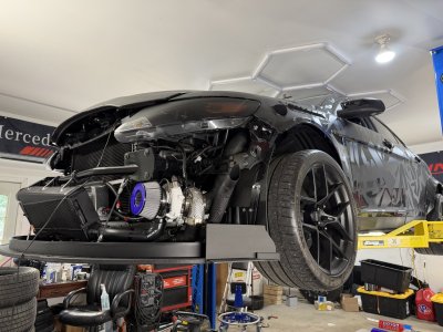

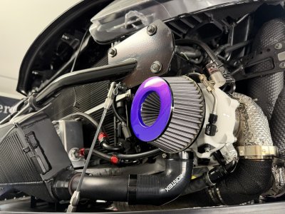

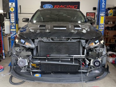

Still waiting on Ryan. Got my stuff from Racetronix finally. 2X the order too bc they reached out on Monday asking if I received it and I said no. They sent one overnight and the original released from Customs.

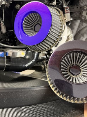

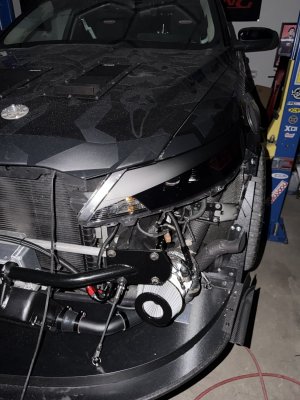

Adjusted the FR toe in. Just waiting for another revision. Changed the filter cone vinyl again lol. And matte black PPF eye brows IMG 9593IMG 9597IMG 9604IMG 9602IMG 9599
Time to test fit the bumper. I want to cut some of it open more, add back 1/4 HDPE plastic sheet access panels. Either large enough openings to leave the wastegate dumps on completely or at least enough room to install them after.
Bc of the fender liners my install for the bumper requires me to use my lift and install the vband clamp from under the car. Not ideal.
I could cut a larger openings and use bolts or rivnuts (although I’m not fond of rivnuts in plastic, have to finesse it and not compress them all the way) to reattach a cover to that opening. Something I could use to do much faster front bumper changes. Could be all plastic or part mesh and also vinyl wrapped to blend in with the rest of it.
Here’s a render of the idea of it using some mesh IMG 9214

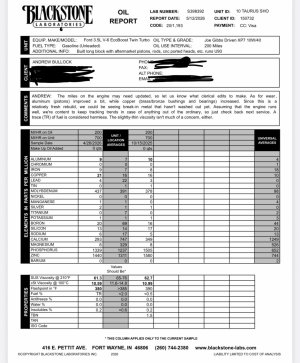

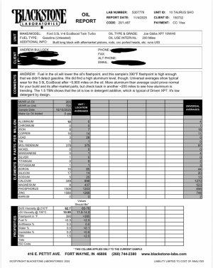

One thing I’ve been finding really interesting lately is oil analysis on this build as it continues through commissioning/testing.
This latest sample came from the same oil used all winter. The car saw:
-repeated tuning/logging sessions
-extended idle time
-cold starts
-short-trip testing
-hard pulls
-troubleshooting electrical gremlins and bad parts
-lots of heat cycles and system changes
Both samples so far have been pulled cold, so while it’s not the ideal lab method compared to a fully hot mid-drain sample, the trend comparison is still consistent because the sampling method has been the same each time. A hot sample is usually more evenly mixed and circulated while a cold sample can leave some material settled or suspended differently.
For context, for the people following who aren’t members or haven’t seen the full build thread, these are the engine mods:
-closed deck conversion
-Manley Extreme Duty pistons
-Total Seal piston rings
-Manley H-beam rods
-micro-polished OEM crankshaft
-WPC-treated crankshaft, camshafts, and piston pins
-King rod bearings
-King main bearings
-ARP 2000 main studs
-ARP 2000 head studs
-Boundary billet oil pump gears
-Cometic gaskets
-CNC-ported heads
-Supertech valve springs
-performance 5-angle valve job
-OEM valves
-new water pump
-new timing chain assembly
-all new seals and sensors
What I found encouraging was despite all the chaos that comes with commissioning a fresh high-performance build, the wear trends actually looked pretty controlled.
-Aluminum slightly improved from the first sample instead of climbing
-iron remained stable
-fuel dilution stayed low
-insolubles remained controlled despite winter operation and lots of idling/testing
That’s the kind of stuff I pay attention to because trend analysis tells a much bigger story than a single pull or dyno graph ever will.
Huge respect to Blackstone Labs too. They were interested enough in the setup and operating conditions that they asked for additional follow-up information because builds like this apparently aren’t exactly common submissions.

One thing I realized after sending additional follow-up information to Blackstone Labs is just how many external oil system components are actually involved in this build beyond just the factory engine oil passages.
That context matters.
Initially the report already looked encouraging for a fresh built high-performance EcoBoost. But after stepping back and laying out the full oil system, honestly the results actually look even better for the system as a whole.
A few of the external oil system components involved:
-Turbowerx mil-spec scavenge pump
-phosphor-bronze pump gears inside the scavenge pump
-Straight Boost twin turbo oil scavenger tank
-Turbosmart one-way returnless oil pressure regulator
-sandwich plate with external oil pressure probe
--4AN turbo oil feed lines
--10AN turbo oil return/scavenge lines
Every single one of those components was installed brand new at the same time as the built motor and all currently share the same mileage and break-in period.
That matters because the oil is not only circulating through a freshly built closed-deck EcoBoost with forged internals, it’s also circulating through an entirely new external turbo oiling/scavenge system with additional lines, regulators, fittings, reservoirs, sensors, and even phosphor-bronze geared hardware.
During this same period the car also saw:
-extended idle time
-cold starts
-short-trip testing
-hard pulls
-electrical troubleshooting
-significant heat cycles
-refinement of the turbo oil drain/scavenge setup
So when I look at the wear numbers now, I think the overall picture actually becomes more encouraging, not less.
Instead of seeing an isolated engine with slightly elevated wear metals, we’re looking at an entire freshly built and freshly commissioned oiling system all wearing in together while being actively tested and refined in real-world operation.

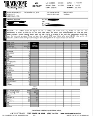

First built 6F55 transmission oil report is back.
Overall, honestly, I think this is a pretty good beginning considering what this sample actually represents.
Unlike the engine break-in oil, this transmission fluid was not treated to an immediate early flush at like 15 miles to aggressively remove initial wear material and assembly debris. This was basically the first real commissioning fluid while the entire built transmission/driveline system was wearing in.
The transmission had roughly 400-500 miles on the first fluid fill. Then I did a drain and fill with Driven AT6 mixed into what was still left in the unit. This sample had roughly 200-300 miles on that mixed-fluid setup.
Transmission/driveline setup:
-6F55 with 2.77 final drive
-fully disassembled and hot washed
-brand new valve body/solenoid assembly
-new seals and filter
-Durabond seamless bushings
-Seal Aftermarket Products Hi-Per Blue molded pistons
-welded planetary gear pins
-Helix Autosport prototype clutches
-Traction Concepts LSD conversion in front differential
-GH converter
Blackstone’s overall interpretation was still encouraging:
-AT6 didn’t appear to cause an additive-related problem
-most iron and silicon looked consistent with early wear-in
-insolubles were slightly high at 0.1%, so changing the fluid was the right move
-no coolant or water contamination detected
That insolubles number is worth keeping in perspective. It was flagged, but it was still only 0.1%. So I’m not saying the transmission was full of garbage or that the solenoids were destroyed by dirty fluid.
What I am saying is that on a fresh built transmission with a brand new valve body/solenoid assembly, fresh clutches, fresh bushings, fresh seals, and early break-in material washing through the system, even a small amount of debris/oxidized solids could plausibly contribute to less-clean hydraulic control or TCC behavior during early commissioning.
There is also the possibility of small amounts of early AN hose cutting debris from assembly/plumbing work. I blew the lines out during assembly, but I honestly don’t remember for certain whether I also brake-cleaned every line afterward.
So between:
-fresh clutch material
-fresh bushings
-fresh seals
-fresh solenoid body/valve body assembly
-break-in wear material
-possible tiny assembly debris
-fluid experimentation with AT6
-thermal management changes
-adaptive learning behavior
Honestly this report makes me wonder if at least part of the earlier shudder/converter behavior was dirty early break-in fluid, mixed friction behavior, low-temp operation, and adaptive learning noise rather than immediately assuming hard-part converter failure.
Since this sample, I’ve already done additional drain and fills and moved the system closer to straight Mercon LV. I’ll probably do another drain/fill in roughly 100 miles or so, but I’m not planning to send every single fluid change out for analysis.
The goal is not to analyze every drain pan. The goal is to track trends over meaningful mileage checkpoints.
So the next sample I care about will probably be around another 500 miles from now, engine and transmission together, even if there is another fluid change in between.
This first report is basically the dirty early commissioning sample. The next one should tell a much better story once the system has had more clean fluid through it and more miles to settle in.

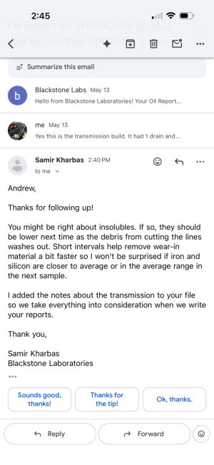

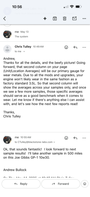

Interesting follow-up from Blackstone after I sent them more info about the engine build and oil system.
Basically, because this engine is so far from a normal factory 3.5 EcoBoost now, the universal averages are only going to mean so much.
They said going forward, the second column on the report, the Unit/Location Averages column, will become the main wear-metal gauge once I have more samples.
So basically the engine is going to get judged more against itself over time instead of just compared to a stock 3.5 EcoBoost average.
That makes sense to me.
This is not a normal stock engine anymore:
-forged pistons/rods
-custom ring package
-King bearings
-ported heads
-external turbo oiling/scavenge system
-twin turbo setup
-different oil strategy
-lots of commissioning/testing miles
I’ll attach the screenshot of what they said, but that’s honestly exactly what I was hoping for with these reports.IMG 9629
Not just “is this identical to an average stock motor?”
More like:
-how does this engine trend against itself
-are the numbers stabilizing
-what becomes normal for this exact setup
That’s the useful part.

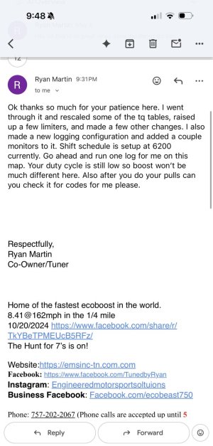

That’s also why Ryan’s latest revision makes perfect sense.
Manually rescaled torque and load tables. Raised some limiters. Added additional monitors. Lowered shift RPM back to 6200. Kept boost roughly the same.
This next revision is not about “making more power.” It’s about seeing if the Green Oak strategy agrees with the hardware behavior more cleanly at the SAME power level.

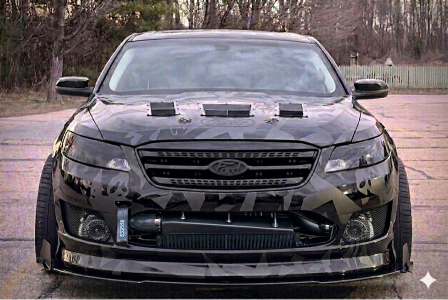

hey look! When I’m not driving my car I too can make AI slop!
